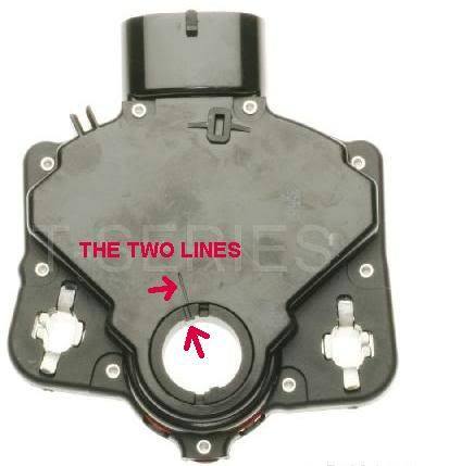

Sounds like your range sensor is out of adjustment. Set your e-brake and put the trans in N,then remove the sensor,line up these marks and install with the trans in the N position.

I checked that and it the marks were lined up

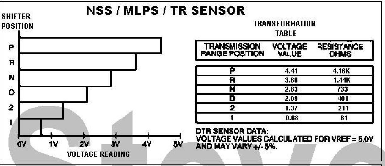

I would refer the OP back to post #2. If the transmission doesn’t know what gear is selected....
If I recall there are either voltage or resistance readings you can check for each gear position to verify MLPS operation.
Yeah,that's right. He can test it if he wants using this.
hmm.Well that's not so easy. Here's a zoomed in part of the section ya need.
