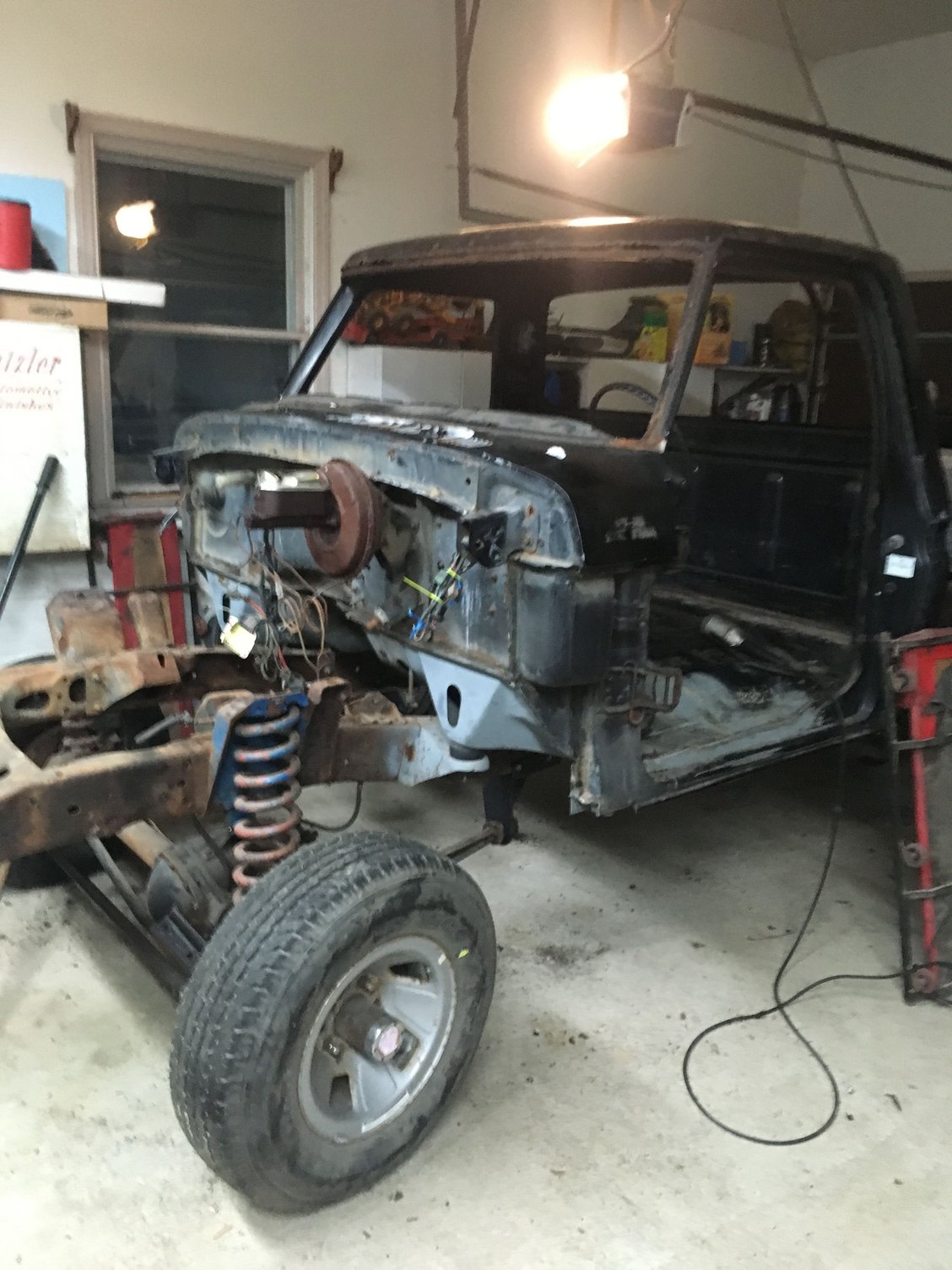

My 1978 f150 has a cab visor and a bad windshield seal. The result was a bunch of rot behind the windshield. Any recommendations on how to go about this? It will be fixed as I don’t have another cab, just a Bronco with the same section that is not rusted out

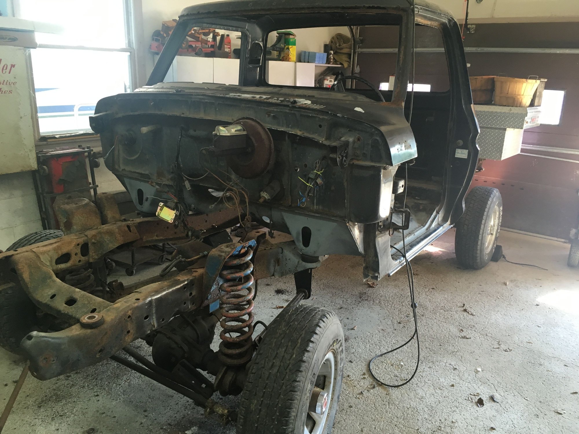

What is hard to see in the pictures is it is a compound bend. It sweeps back and down so both sides of the metal strip had to be worked.
I did it in 2 pieces for ease to work the parts. I would do the same for that roof fix.
It also was not rust, I am flush mounting the front & back glass and this is a filler panel so I have a 1/8" gap all the way around the glass.
The A pillars were easy as they are straight pieces cut & filed to fit.
