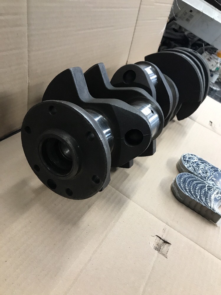

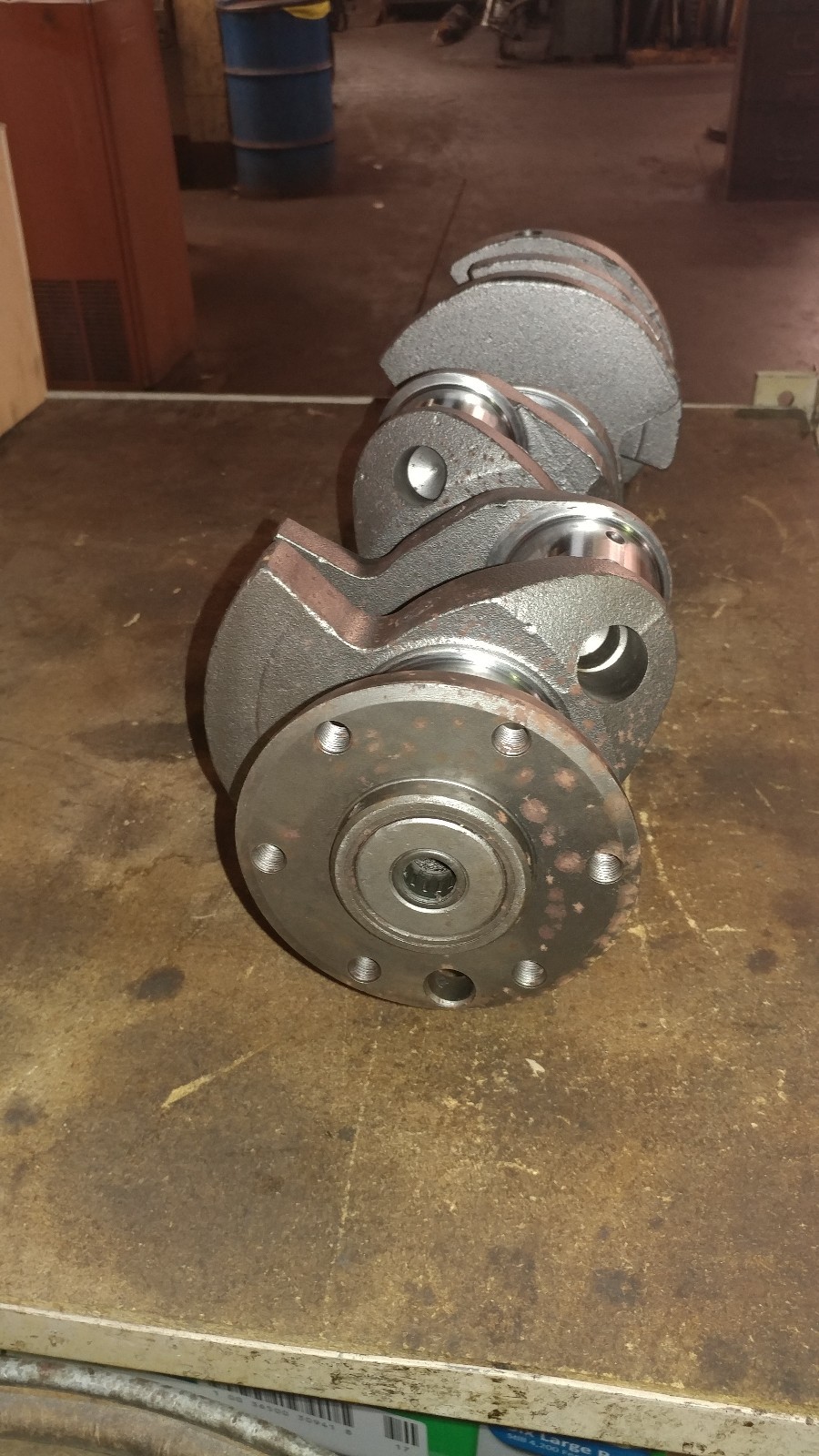

Ok, let me rephrase: does anyone have a 370/429 HD crank lying around that they can snap a pic or two of the rear flange and post it? And likewise, a 460/429 car crank, for comparison purposes? Trying to visually see the differences. Any help would be greatly appreciated.

Hope these are going to work. Went on ebay, searched for ford 370 crank, and ford 460 crank. Plenty of pictures.

Nope. Looking to swap in a Fuller 6-speed into an F350 w/460 power. However, needed to see the flanges to see if there would be a problem, doesn't look like it. Adapting the tranny for a transfer case is also no problem, Dodge/Cummins guys have done so for years. This was actually, in part, my inspiration for wanting to do this (460 w/Fuller trannyin a pickup).
A lot of people claim internal balance for the 370/429, but it has the counterweight in the scalloped out area just like a 460, so at least the back half of the engine is external balance. At least one flywheel (E5TZ-6375J) claims to be for all three, external balance, 180 tooth and drilled for 11, 12, and 13 inch clutches, depending on the source.
Edit: also, all 385 series engines (car 429 and all 460) built from 68-78 are INTERNAL balance, all 385 series engines with the D9TE block (370/429 truck/460) are EXTERNAL balance, due to smaller counterweights because of the deeper cylinder walls in the block. As I said above, the 370/429HD flywheel has a counterweight cast in. Look for yourself, I'll try to find a pic and post.

Also, thanks for the pics Krewat! Greatly appreciated!
