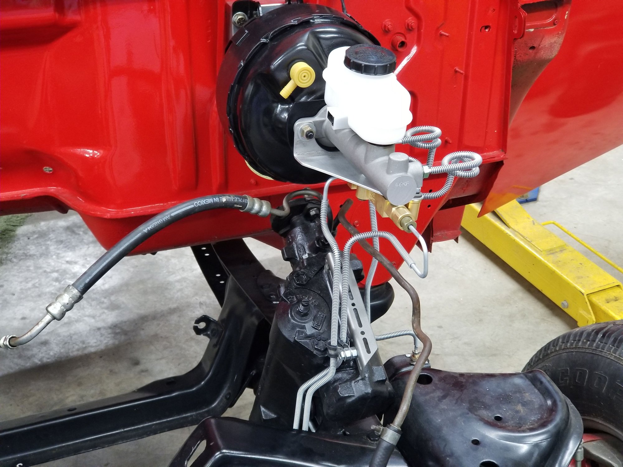

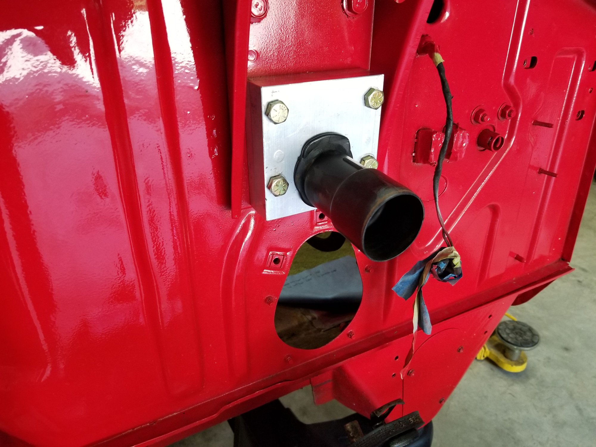

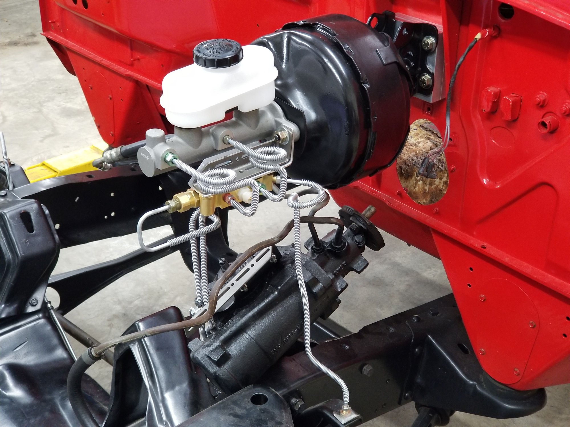

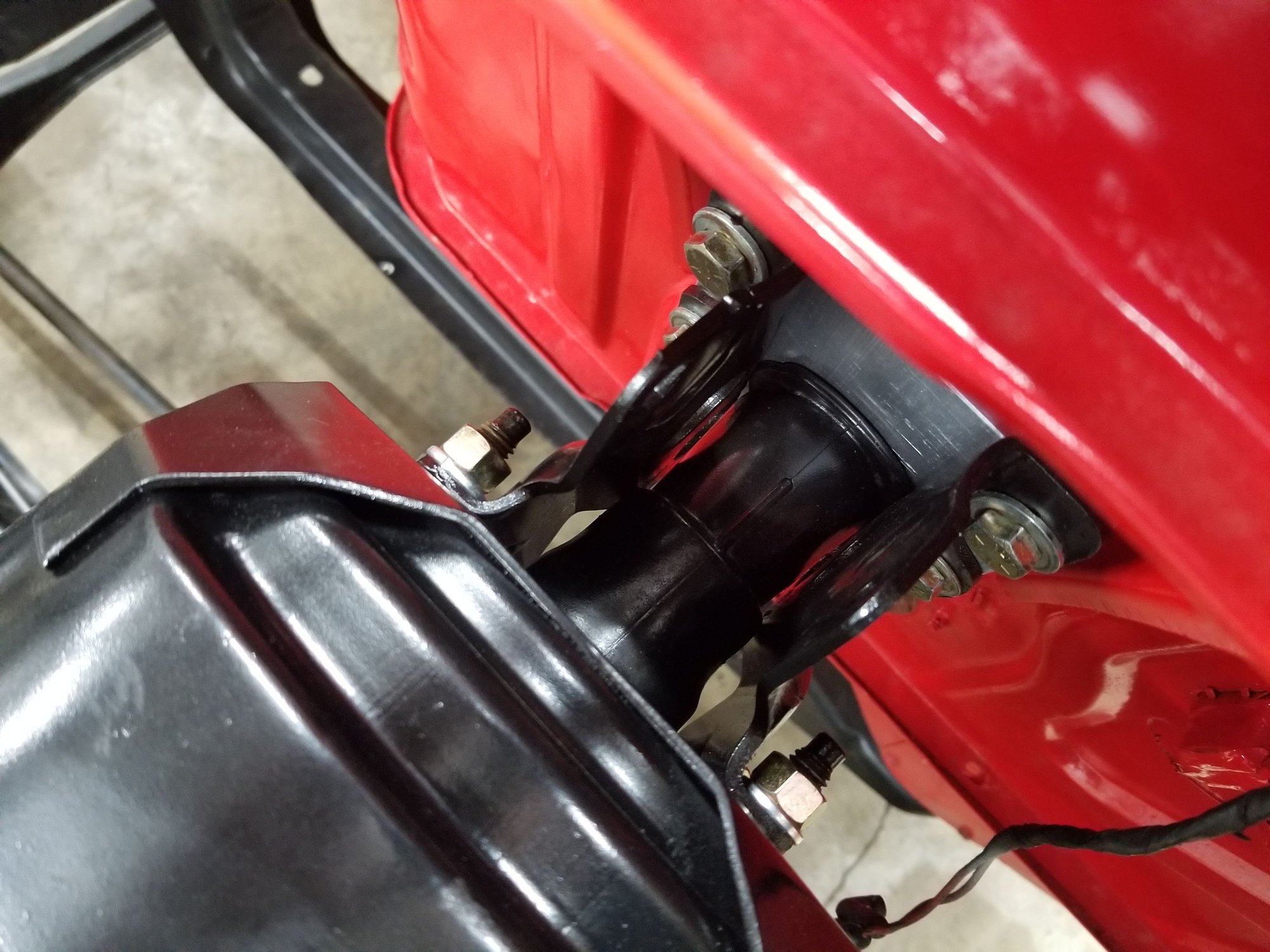

'68-'72 F350 dual diaphragm brake booster/firewall brackets/dust boot and a '95 Ford Explorer MC I installed on a friend's '65 F100. (front suspension equipped with DJM drop beams, '78 F150 front discs. On the rear, stock '65 F100 rear drums).
I fabricated an aluminum spacer to go between the booster mounting brackets and the firewall --pedal pivot location on '67-earlier Ford trucks are much closer to the firewall than on '68-up model trucks.

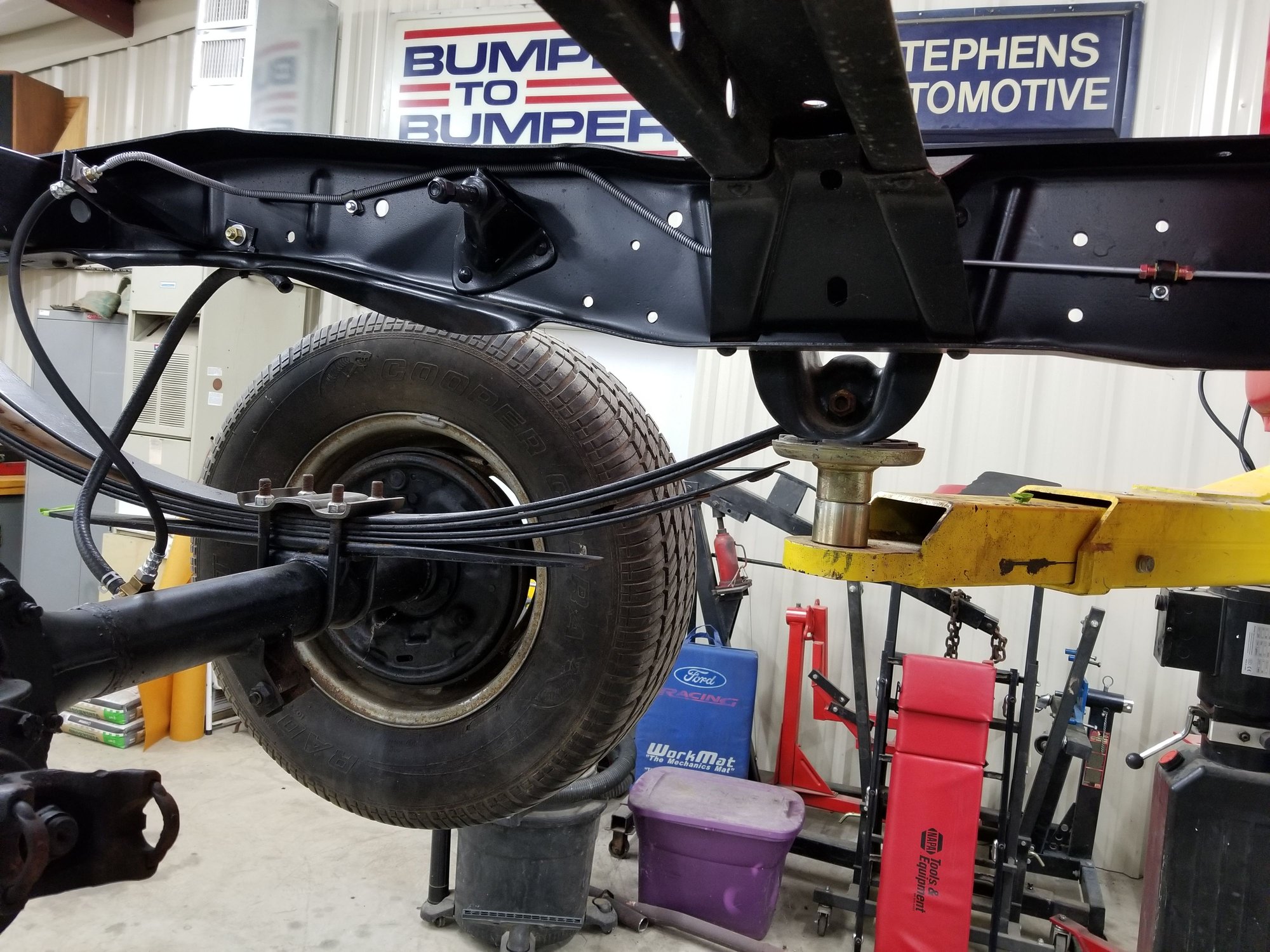

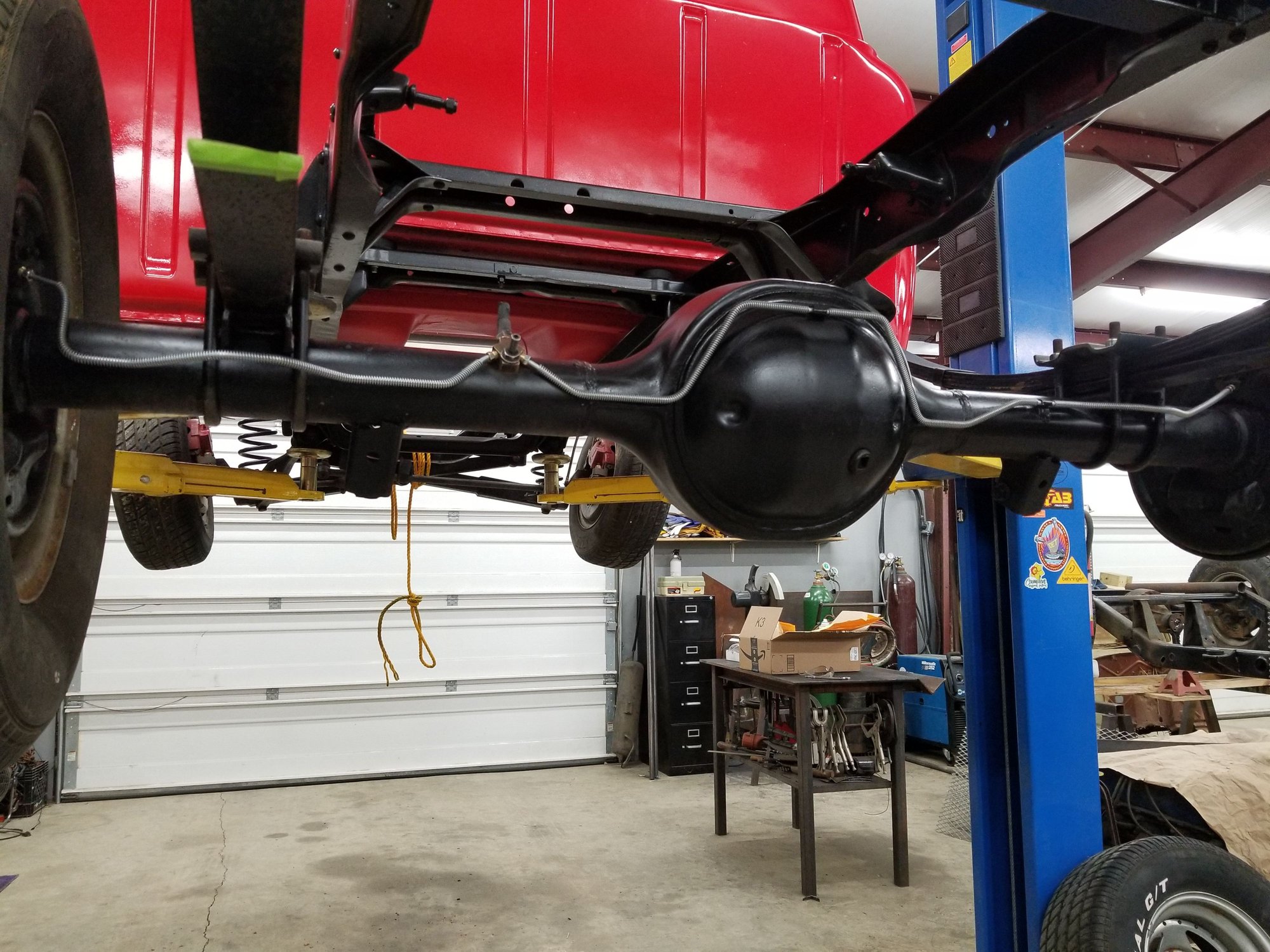

I fabricated all the hard lines from the front to the back of the truck from a couple of 20' coils of 3/16" diameter steel tubing.
