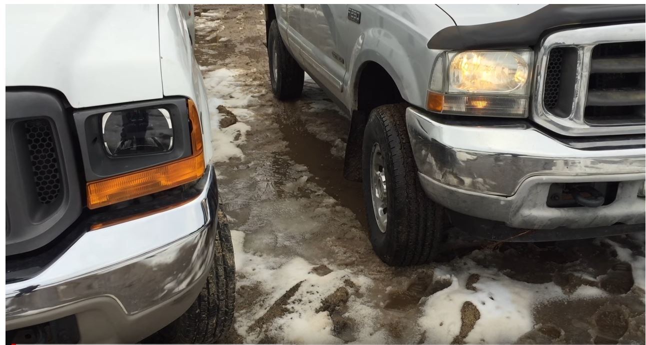

I am currently correcting the previous owners after market one piece replacement lights which didn't even fit the opening. Instead of cutting the existing header, I ordered the 2005-2007 header, and the 2005-2007 headlights from Ford.
From there I will be opening the new headlights and outfitting them with projector LED's, projector HID's are an option too. You could always order the work truck headlight parts as well, and install an LED sealed beam unit as pictured.

I installed the 2003-2004 style units like the truck...^^^...above on the right in the wifes Excursion. They are a direct fit and much better light. I installed the same on my F350 in a smoked lense and I hate driving the thing at night...which isn't much thank goodness.
In conjunction, I installed the 2005-2007 front grilles on both trucks. You have to trim the bottom a little, but it's a better look.
