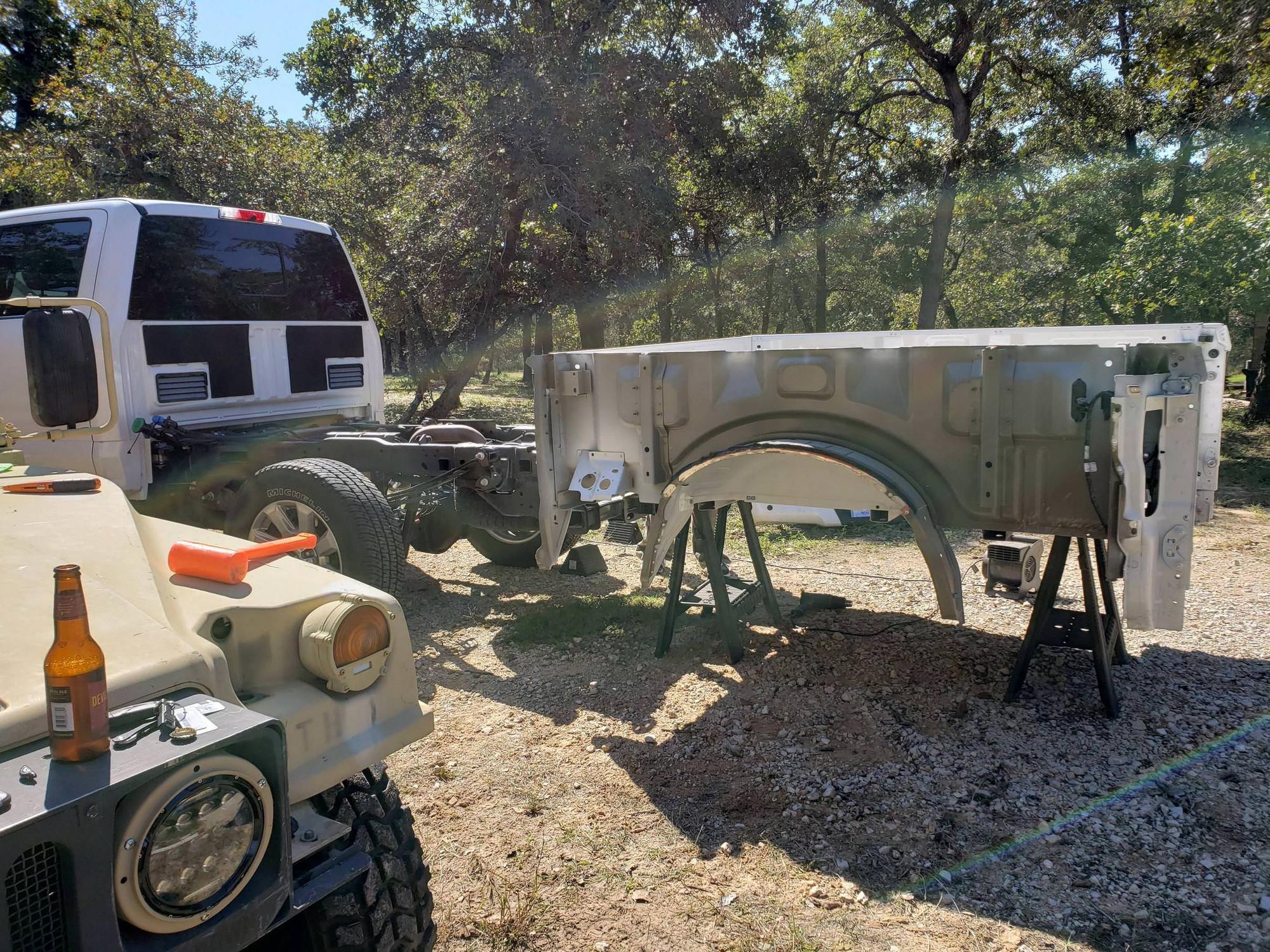

This weekend I pulled my bed to add larger fiberglass bedsides. After I re-attached and plugged all the connectors back in they opened once then closed and now they aren't opening when I open the door. Do I need my tail lights connected for it to work? I haven't put them back on yet, or the adaptive cruise module.
Any ideas? Lift and tires will go on next week, still need to straighten up the body lines and make fender liners.
