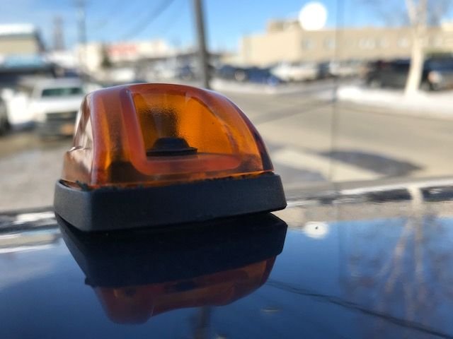

Originally Posted by SDTruckMan
3. Cab Lights.. looking from the front of the truck, the lower part of the lights (black base) looks to be elevated up off the roof of the truck by a small amount. Is this normal or should they be seated down on the roof?
Thanks
Yes, this is normal. They actually are seated down on the roof but there is a lip around the edges that give them the appearance of 'floating' on the back, depending on the angle you view them from. Pics below.

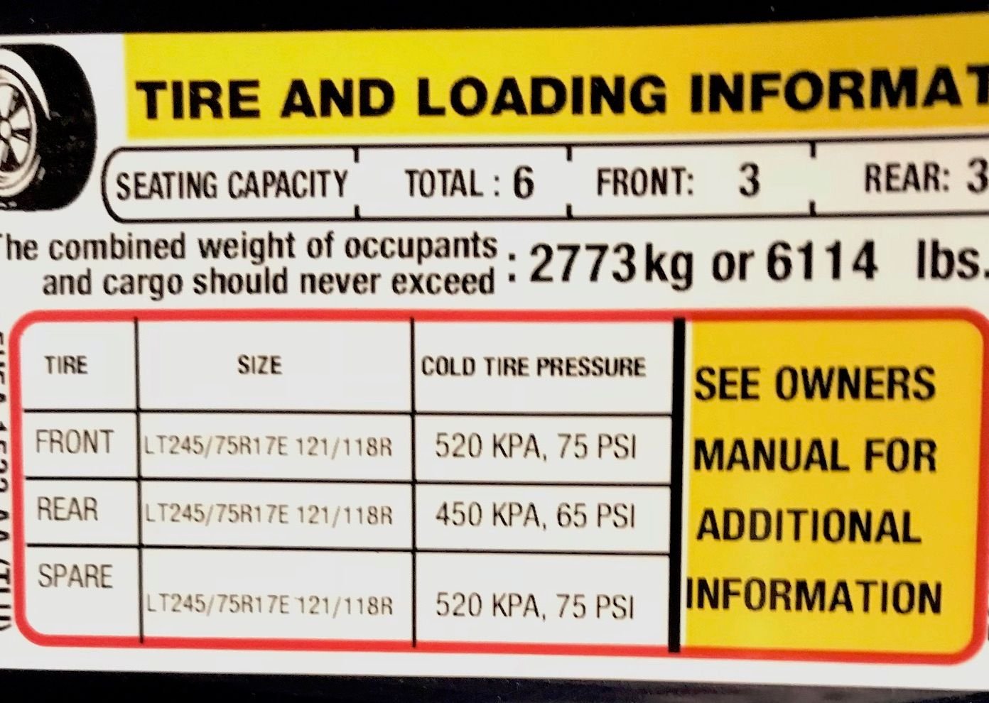

Here's mine. I have the combined snowplow/camper package and about the most cargo capacity you could hope for in an F350, so why do my springs show "CCDD"?

Looks like we need to look up the “CC” code for the front springs and the “DD” code for the rear springs.
A quick internet search suggests a “C” in “CC” is the code for a 6000 lbs. pair of front coil springs; the other “C” appears to be redundant.
Example: https://www.ford-trucks.com/forums/1...l#post17919126
Nothin’ on the “DD”.
Thanks Alaskan Warbird for the pics and the info. Thats basically what they looked like, not having them before had me concerned if they were installed right.
