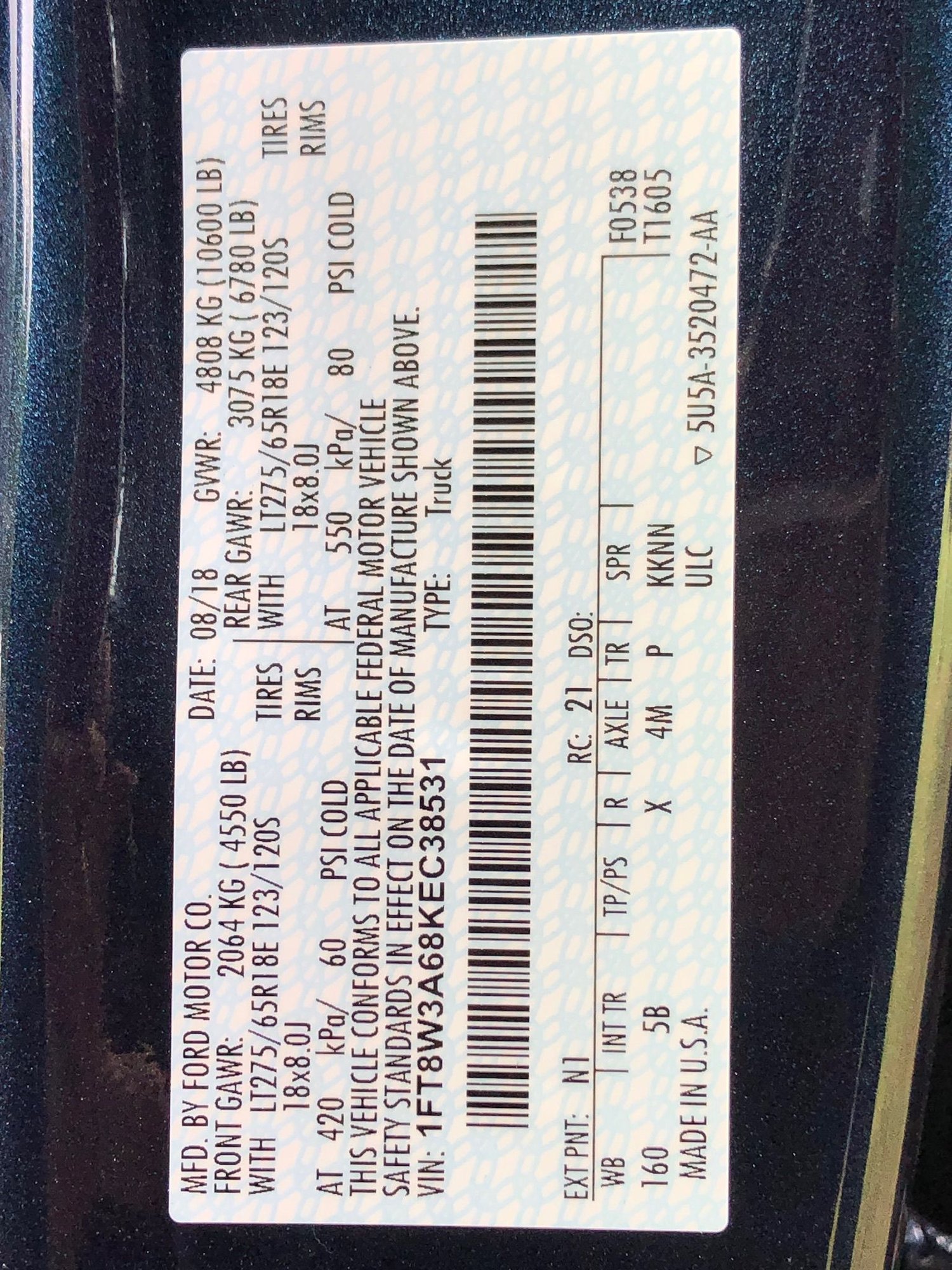

Our truck has the 4.30 EL differential and 4550 lbs. front springs. Here’s what the cert label looks like:

Hey Jim, do you know if they use a different spring code from the 18 to 19 or F250 to F350?
I ask because I have an 18 F350 6.2 gas with spring code CCNN and my front GAWR is 5990.
You would 'think' Ford would be consistent but that might take common sense..
Weird looking at your door tag with the same NN springs, your RAWR is 6780, mine with the
same springs is 7230...

It's apparent the GAWR involves much more than just springs. The codes on mine are - DDDD (5600 lb) and ULC (9900 lb). I do not have snow plow prep.

Originally Posted by tfalk
...Weird looking at your door tag with the same NN springs, your RAWR is 6780, mine with the
Good catch! Our 4x2 truck is fitted with “small” LT275/65R18E tires, so it gets a lower rear GAWR due to the tires’ lower load rating (3415 lbs. per tire @ 80 psi cold).
I may have to “upgrade” to LT275/70R18E tires one of these days...
Regards,
Jim / crewzer
