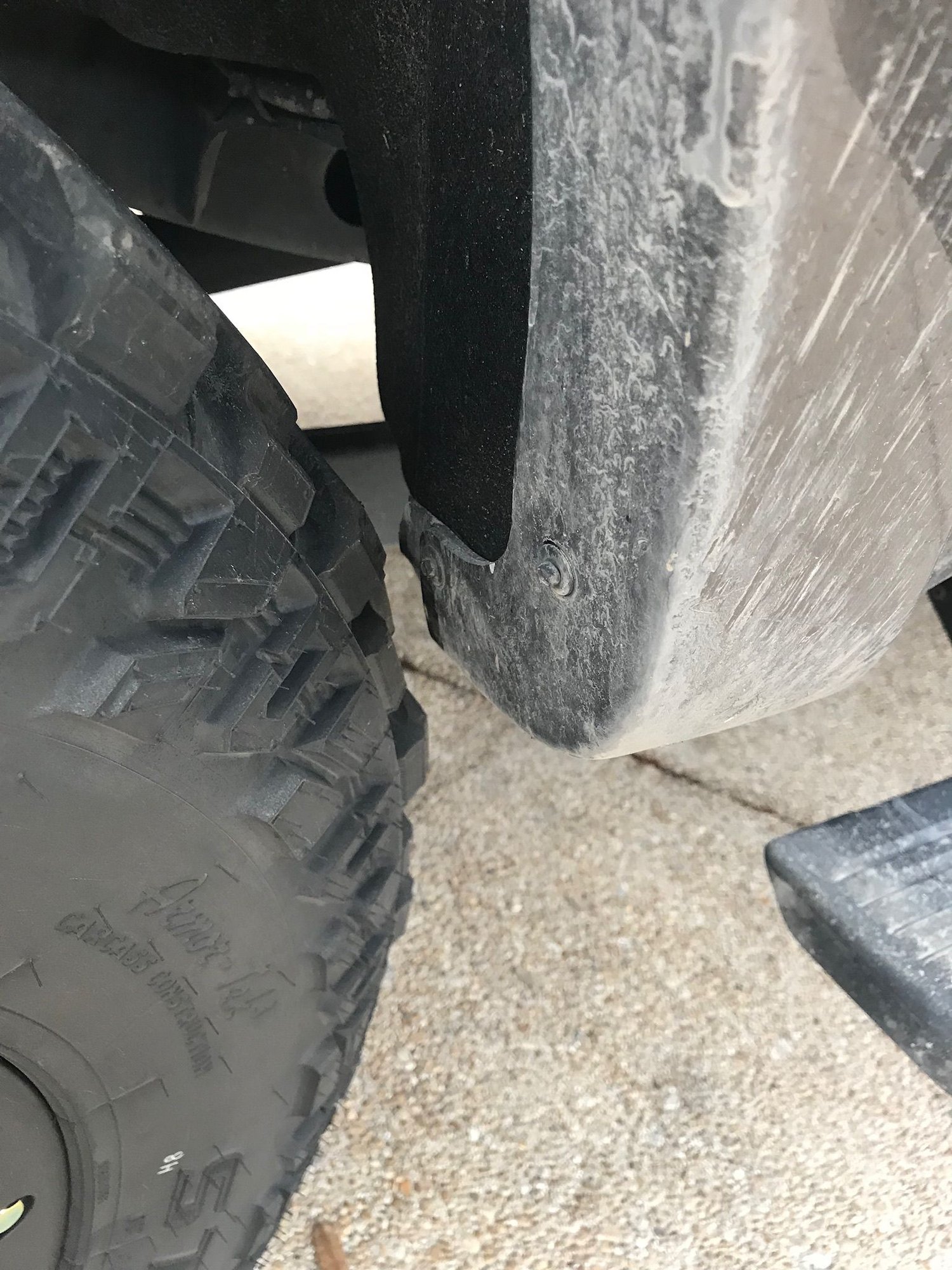

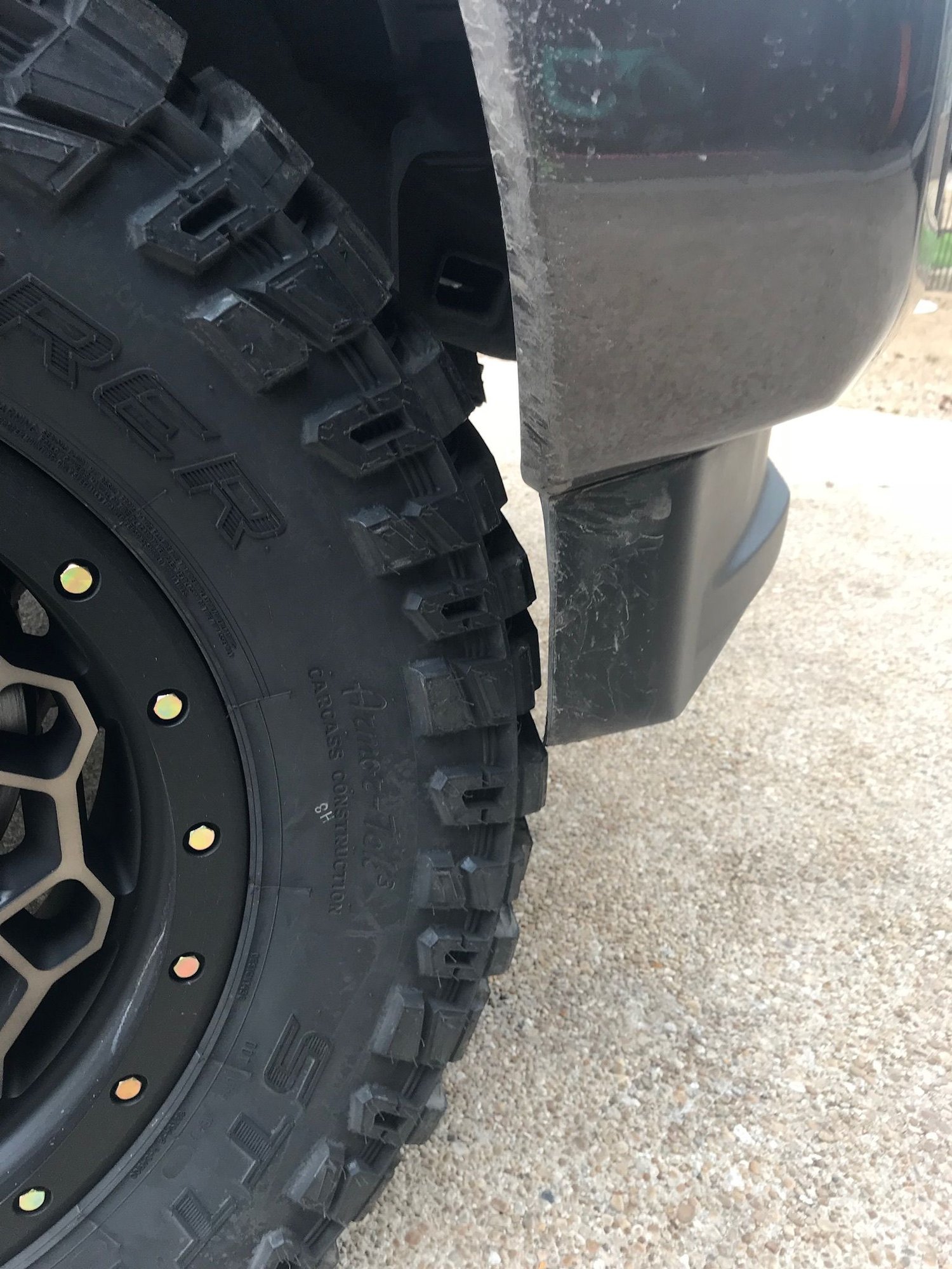

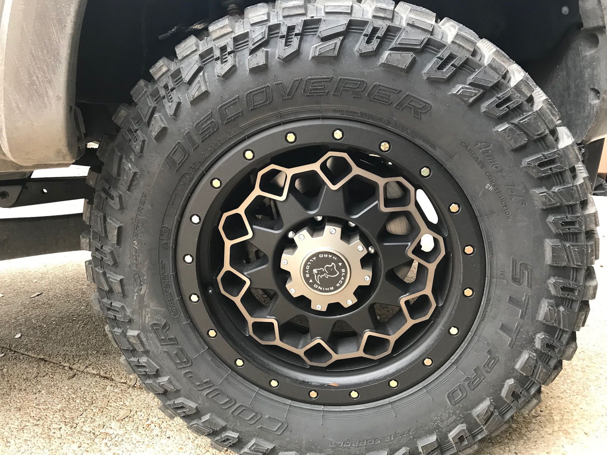

Originally Posted by LiquidSteam
Ok so now I’m looking at a 9 inch wide wheel at +12 offset. The idea is I want 37x12.5 snow tires that don’t rub and don’t stick out very far. I’d live with 37x11.5 but nobody makes a snow tire that size. So it’s either 35x12.5, 35x11.5, or 37x12.5. Based on how my tires fit currently with OEM wheels I am sure that 35x12.5 would fit. 37x12.5 “May” fit if I get the right wheels. I’m just rambling here.... I think I’m gonna just order a 20x9+12 wheel and a 37x12.5 snow tire..... worst case scenario I go with a 35x11.5 snow tire and be done with it
My wheels are 20x9 on 37x12.50 tires and I think a -12 offset. Had to trim the valence and it did rub on the wheel well at first, but I’ve got knobbing mud tires.

Hmm... strange. I have 37 inch tires on already and they are not close to the valance. I do however want black rhinos although I wanted the Armory the Warlord fits the truck better so I’ll go with them. 37x12.5 should fit no problem

Wait.... you must not have any level or lift right? My 2 inch level probably moves my tires back enough so the bumper or valance is not an issue? My issue is the radius arms. Not terrible but does rub at full lock with 37x11.5 and oem wheels
Yes, but I think I’m an inch wider on both the rims and tires than you (see my signature). Plus my offset -12 so my backspacing is probably different.
