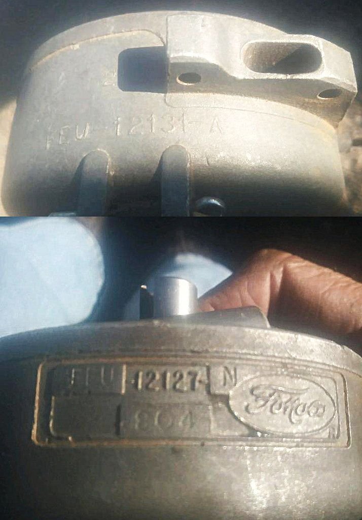

So, we seem to have a resolution to this one... but not what one might expect. Rather than going forward, we went backward.
My dad still had the old distributor and it's vacuum advance. The shop that rebuilt the engine apparently couldn't do anything with it, so they put a new one one and, as you know, hi-jinx ensued.
He found the old one that had always worked just fine with the truck, stashed away. He opened up it's vacuum advance to look... because in 65 years of working on cars, it'd never crossed his mind they could be opened. The diaphragm seems fine ( for now). So he put it back together, plopped it in the truck and... voila! The tach reads well, and the fouling is gone. Sooo... end result is new coil, and a 48-year-old distributor with who-knows-how-old points and condenser.
...Speaking of which: we were trying to pinpoint what the original distributor is. He's not sure if it's original. We weren't sure of a model number, or if it even went to an F-250. There are numbers for individual components, though. I'm looking for the original vacuum advance, too. It has a straight arm. I found something for sale on macsautoparts.com from 1959. Not sure if it's the same.
The Distributor body has this info: FEU-12127 / N FoMoCo and the number 804 below. On the other side of the body, is FEU-12131-A. The plate inside has 905700
The vacuum advance: when opening it, the underside, had FEU-12131-A . And the housing had FEU-12121-A ... It seems hard to find, because most of the vac. advances out there have the curved arm. This one is straight.
All these FEUs... they don't match the naming convention. but I've seen some suggesting that FEU was indeed used by Ford early on. Could this be a 1957 distributor on our hands? What the heck??!
Pics:
Pics:
FEU 12127-N is the DIST ASSY ID NO.
PREFIX FEU was assigned to the 1958-59 model years 292-332-352. This complete ID is not in the PASS CAR MPC so it must be truck only (I do not have the period TRUCK MPC). The 12131 is the DIST HOUSING CASTING ID NO.
Listen. That DISTRIBUTOR is valuable. When FORD first went with dual advance (1957) it used an upper breaker plate that rotated on roller ***** instead of a hinged breaker plate (1959/ ).. The correct vacuum advance is B7A 12370-A and you can still find them NOS along with the special breaker plate.
What you dad took apart was the shim adjustment of the vacuum advance (common early style). That is how the vacuum advance curve was adjusted.

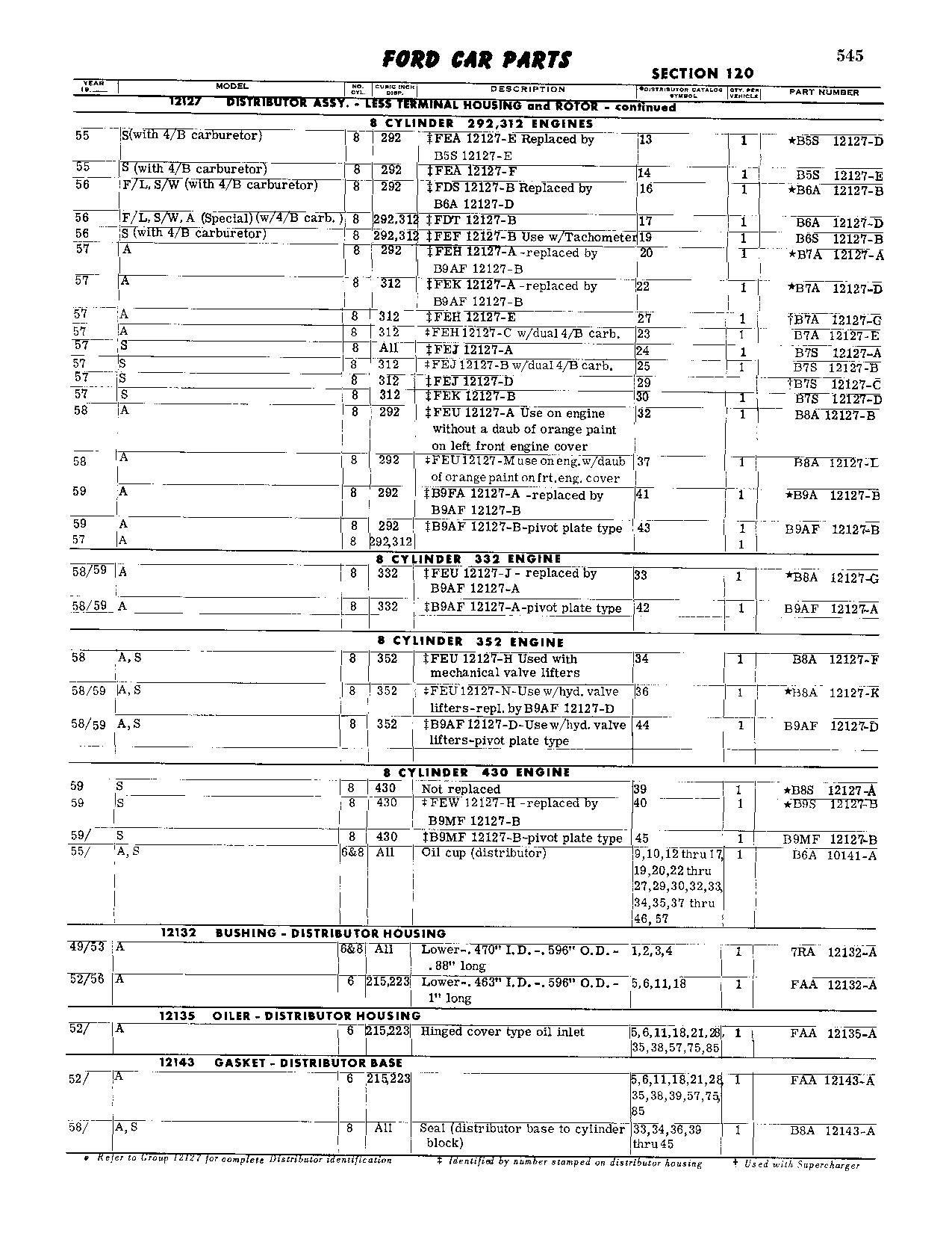

EDIT:
Pic: FEU-12127-N = 1958/59 352 Ford/Thunderbird.

EDIT:
Is that page from the 49/59 MPC or a different text? My FINAL ISSUE (CD) does not show that ,,,
You're cheatin' ...
EDIT-
...yes ... it is there ...
I overlooked it.
You're cheatin' ...
EDIT- ...yes ... it is there ...I overlooked it.
hmmm.. a new question, for those who've put on adjustable vacuum advances...
Pops went to NAPA and got an adjustable vacuum advance. (yes, even though he's got that good old washer-adjusted type. He's got the newer NAPA distributor in his hands, trying to understand the papers that came with this new vacuum advance. It shows 20 years worth of Tag IDs, and how many turns to adjust it.
But his distributor doesn't have any tag on it - just the 12127.
The dizzy ID number you posted in post # 46 is FEU-12127-N .. This cross references to: B9AF-12127-D (replaced B8A-12127-K) = 1958/59 Ford/Thunderbird 352.
