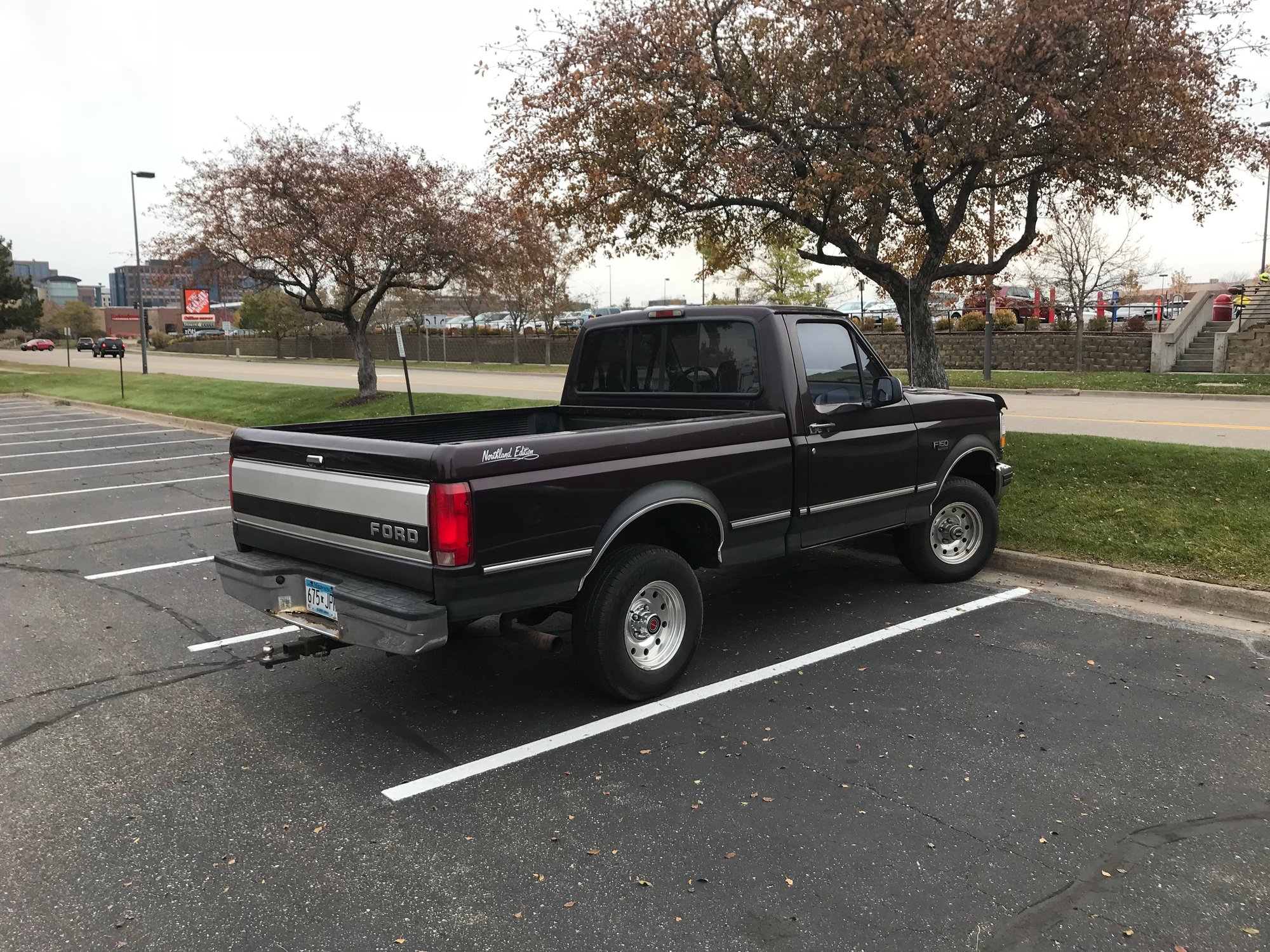

This is my F150. Kind of a unique color. I don't think I would have purchased it with this color brand new but it's not too bad.

Nice truck ��
