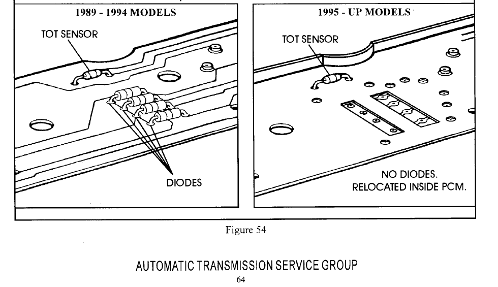

Ok, riddle me this: could I be super crazy and just add the correct diodes to the solenoid pack? In the picture it looks like the circuit board still has the populated holes for them. Obviously figuring out which diodes to use would be the bigger question - but it does look possible.
**I know, if I am going to break the whole thing down, I might as well swap the diodes too. Just thinking out loud.

Yeah they are all the same.Gas or diesel.F150-F450.'89-'94.There's technically and older and an updated type in this year range but since the old style wasn't failure prone,don't worry about it.Anything you find,including your old one has a 99.9% chance of being good.
