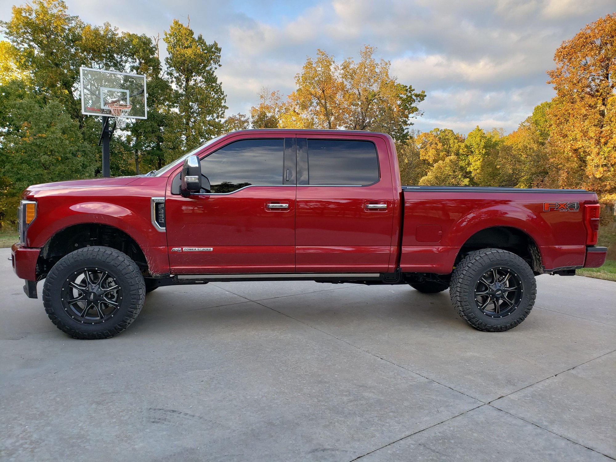

2inch zone. Rides fine but front axle offset to the left some. Is this a track bar bracket fix?

Yes an adjustable TB or bracket will re-align the axle. I would go with the adjuatable bracket so you can dial it in correctly. Most of the TB brackets have a lift range so it wont be perfect. Just a thought.
