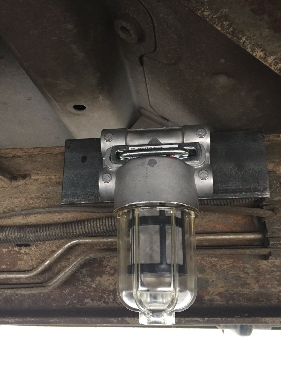

I used 3/8 barbs, with 3/8 fuel injection hose. Starting at the tank, I pushed the hose over the barb coming off the sending unit tripped clamped that one, then threaded hose to the RACOR filter 2 clamps, then on other side of RACOR 3/8” with 2 fuel injection clamps to the back side of the pump. I left the stock lines in place.

‘The 3/8” hose and barbs works perfectly. So guys like the 5/16 because it fits a bit tighter. No mess of adapters needed. Are you planning on using a RACOR filter?
I left a loop of hose in case I need to cut some off.

Very clean install @Colorado350 . I always appreciate a measure of "service loop" in both hoses and wiring should the need to change ends or make other adjustments arise.
I have the small RiffRaff inline cartridge filter for now. Used lots of Racors in the marine industry, if the RiffRaff doesn't cut it I'll upgrade. Thanks for the pics!
