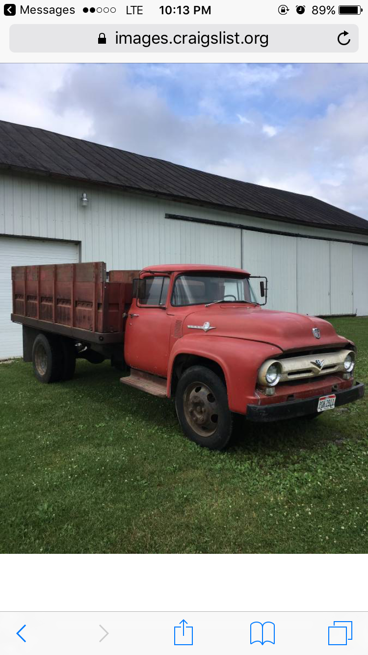

They won't rub
9r 22.5 on this rig

The 8.25 x 20's (9R22.5) were only offered on F-6 & F-7 trucks, so there could be an issue with the fronts on a F-5. F-5 trucks came with 6.50, 7.00, and 7.50 x 20 tires.

Find this picture on the Internet.
