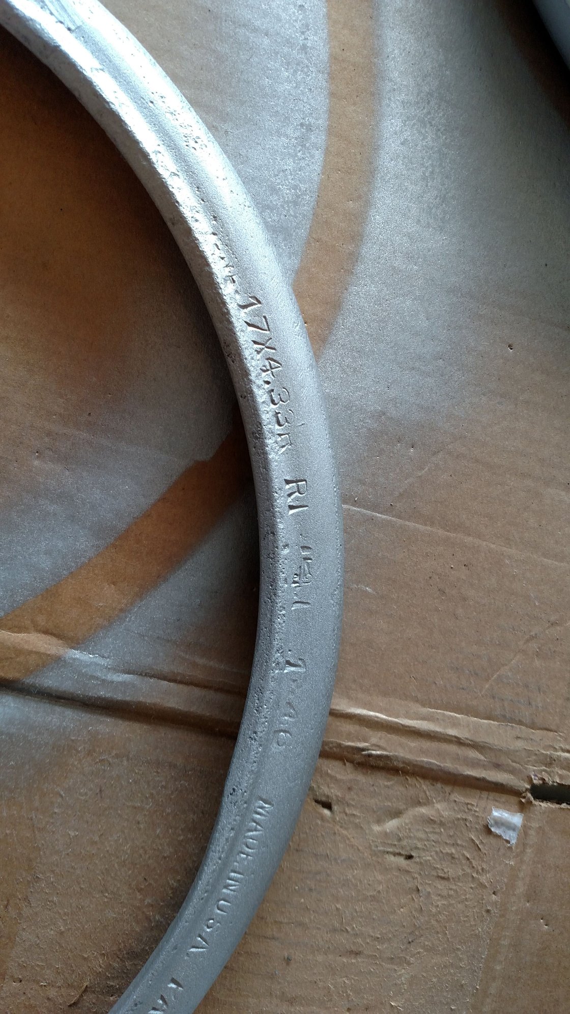

Old Apr 28, 2016 | 09:04 PM
Rickster800's Avatar
Rickster800
Posts: 267
From: Lincoln NE
Thanks Stu. Here is a pic of the RI rings that I have. They are on the 4.33 width Firestone RH wheels.
Old Apr 28, 2016 | 09:38 PM
truckdog62563's Avatar
truckdog62563
Marmon-Herrington Man
Joined: Jul 2005
Posts: 11,986
Likes: 446
From: Central Illinois
Outstanding. Below is the old thread about casper1999's "new" F-3 M-H. You'll find the ring pictured on page 9. I don't believe he's retrieved the truck from MT yet, so you might get your order in early. Stu
