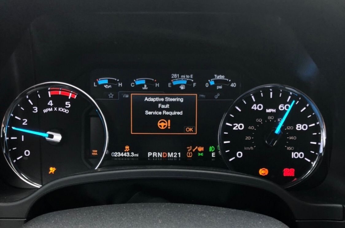

My ‘17 f250 (08/17 build date) has been having loads of electrical issues off and on.
ABS,Parking Break,Traction control,hill descent, Adaptive steering fault, Check 4x4, Airbag, service front cam,etc... MOST lights in my truck are on!
They seem to only come after driving when its
wet outside as they come and go but this time it seems they don’t plan on leaving.
At times none of the buttons on the steering wheel work. Not volume, Forward/Backward songs, Media, Not the y’all buttons, cruise control, nor the OK and surrounding arrows. Blinkers will not work and Neither will the high beams.
i also experience 911 Assist Messages and Navigation Not functioning properly on my big Navigation screen and the map will not work.
The volume will get stuck @ full volume and once you turn down it will instantly turn itself back up.
The truck has had dpf & Egr delete since the day I bought it and this just recently started happening. I don’t believe they’re the culprit but it must be the Bcm...
I checked the grey/cream colored
plug by spare tire most people have issues with and it was fine!
I am at a dead end here and looking for some
advice.
thanks,
JB

I have seen all of the threads regarding the plug on the back and checked all of them. I pulled all fender liners out and really looked at all wires/connections and wiring harness and everything checks out.
I am also thinking it’s corrosion related because it’s off and on. I don’t think the whole bcm went out, just think it gets bad connection from time to time or when it’s wet/moist...
