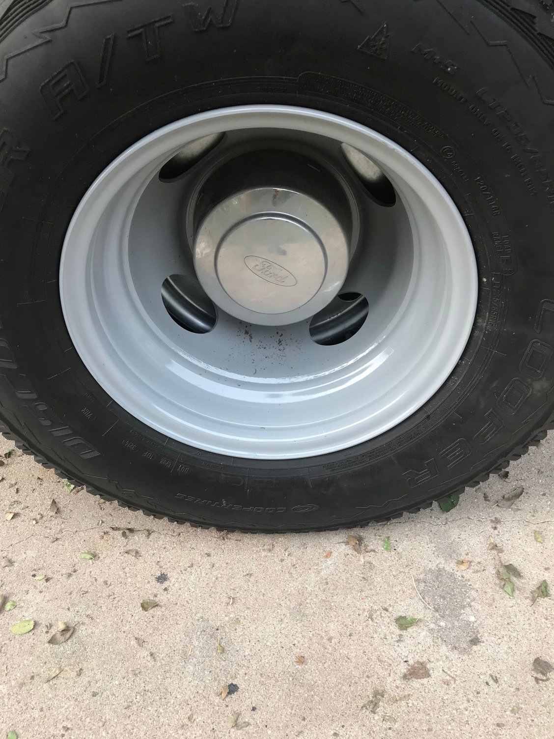

You can see here how the actually line up with the center of the wheel once it’s reinstalled.
Once the wheel is reinstalled , they are slightly visible
