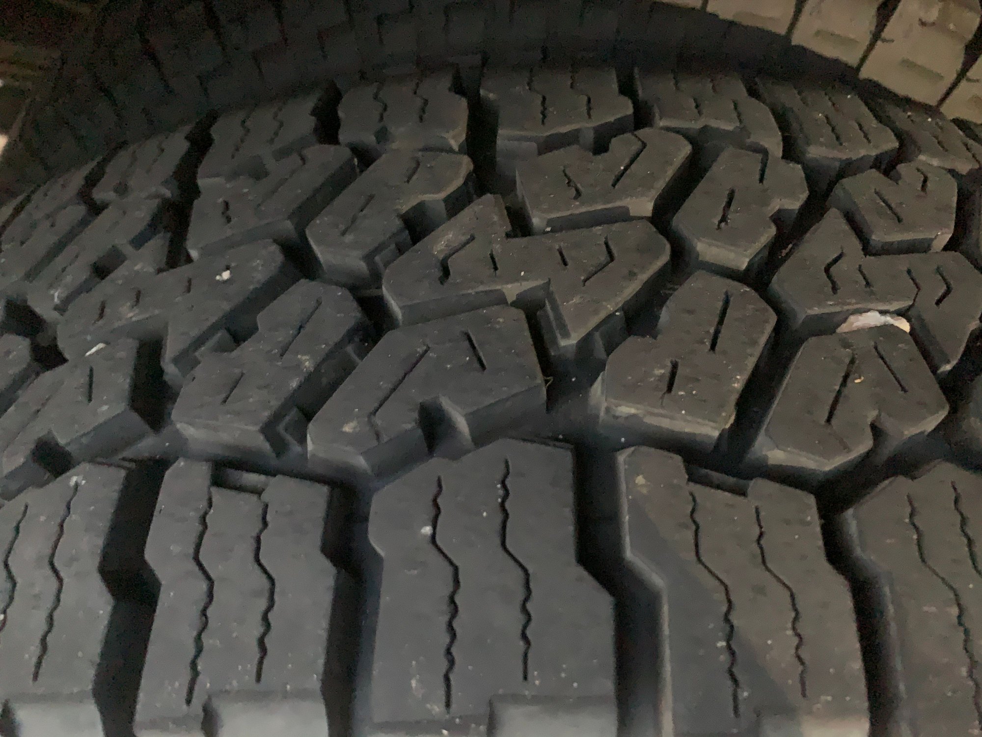

I figured it would be good to update this thread and the tire wear I’m seeing with the Centramatic Balancers. The measurements below are from August 2020. I have maybe another 500+ miles on the tires since August. The tires continue to wear evenly, I rotate them every 5K.
AUGUST 2020 UPDATE:
So I checked the wear on these tires today. They are wearing exceptionally even and still look like new tires. I’ve been running these tires, since new, with Centramatic Balancers. It would appear that the Centramatic Balancers are definitely playing a significant role in how well these tires are wearing.
10,396 miles on tires
DS OUTER -13/32
DS INNER- 13/32
PS OUTER -13/32
PS INNER-13/32
NEW TREAD DEPTH PER FALKEN 17/32
A loss of 4/32 over 10,396 miles...

Let's see the FRONT tires.

The front tires were JUST replaced they were from the original set I put on the truck in Jan 2016 long before the Centramatic were installed. I put the same tires on the front as you see on the rear.
