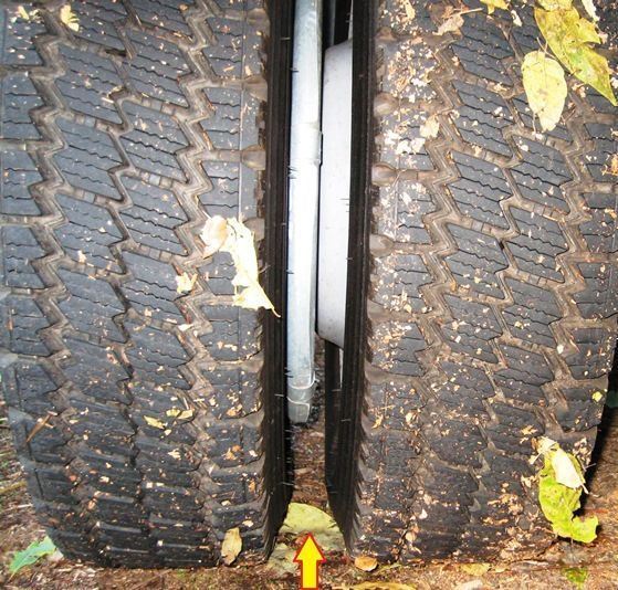

2. The disc flats are drilled for multiple applications, and this can present a fitment issue when aligning valve stem locations with the access holes on the disc for the rear dually pair on 19.5" wheels with five hand holes on the wheel. There are only two hand access holes on the Centramatic disc, so right away you can see the issue. 2 can match with 4, 6, or 8. But not with 5. Compounding the matter further is that the entire bolt circle of the Centramatic disc is riddled with holes to fit various applications having different bolt circle diameters, stud diameters, and number of studs. The correct constellation of holes that fit the pattern on my hub limited the clocking options on the disc for cross alignment with the hand holes (and valve stems), restricting access to the inside dual valve stem. Centramatic attempts to resolve this by making their handholds longer, and more oblong.
I found that these holes were not oblong enough. After discussing the issue with Jerry (many years ago), he said he would send a note to manufacturing identifying the issue. He also reminded me that since these are dynamic balancers, I cannot hurt them by drilling new holes in the mounting disc where I would like them. Even if I was not accurate in matching the material removed, the physics in the torodial ring would not be effected. Just as the ring balances the tire, wheel, hub, and rotor... it also balances the disc that holds the ring. I used hole saw to evenly extend the oblong-ness of both access hand holes on the disc, in opposing directions, which was enough to improve access to the valve stem of the inside dually.
Note that the foregoing issue applied to the 8 lug 225mm bolt circle diameter 19.5" wheel, which is the only application I can report personal experience with. It may not apply to the 10 lug 225mm bolt circle diameter 19.5" wheel, nor may it apply to 8 lug 170mm or 200mm bolt circle diameter 16", 17", 18", or 20" wheels. Nor may it apply to newer Centramatic discs manufactured in the last 8 or more years. But if it does apply to your application, know that center disc can be redrilled to match your needs, and that Jerry has approved the modification in my case.
