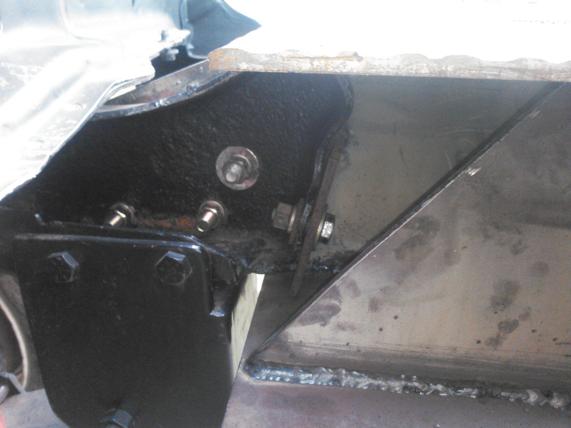

Time to get to fabbing some brackets, no big heavy metal cutting or welding abilities? Make some patterns out of cardboard, that make the brackets bolt to your bumper and bolt to your truck frame, and take to a local welding shop or Vo Tech and have them knock it out. Here is what he means about using the front leaf spring hdwr to mount it. Of course this push bar works with a OEM bumper.

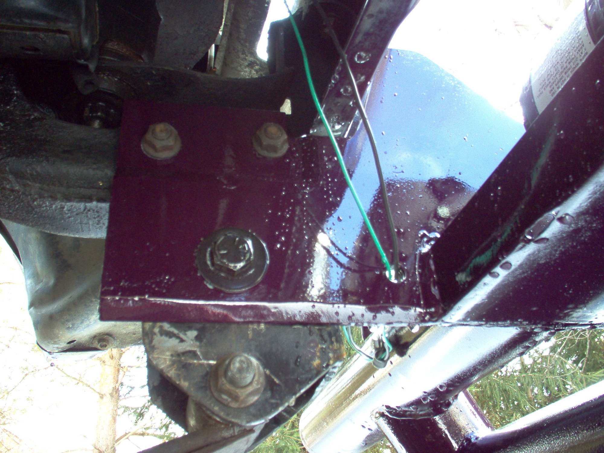

It looks like the guy with this bumper used square tubing.

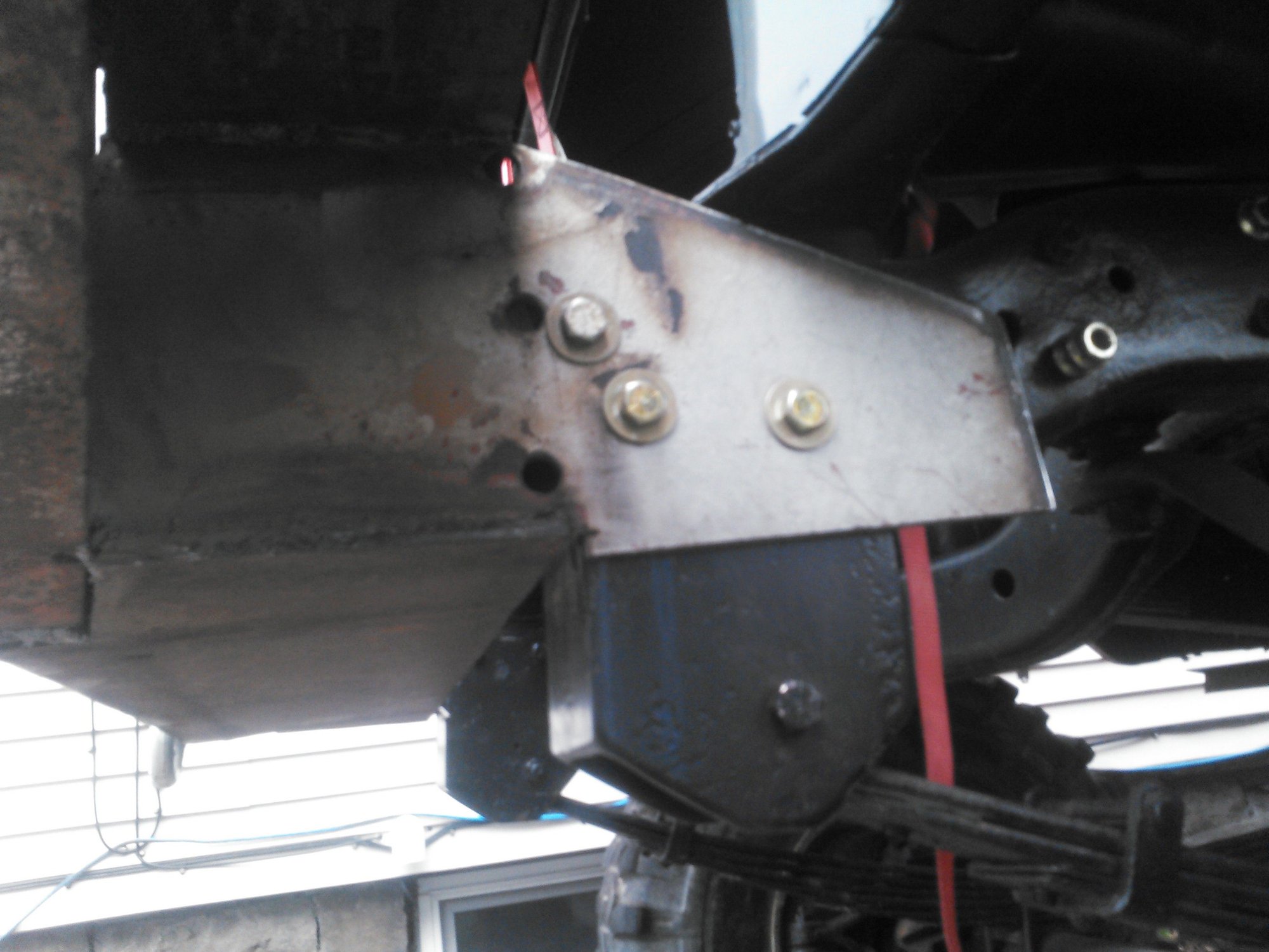

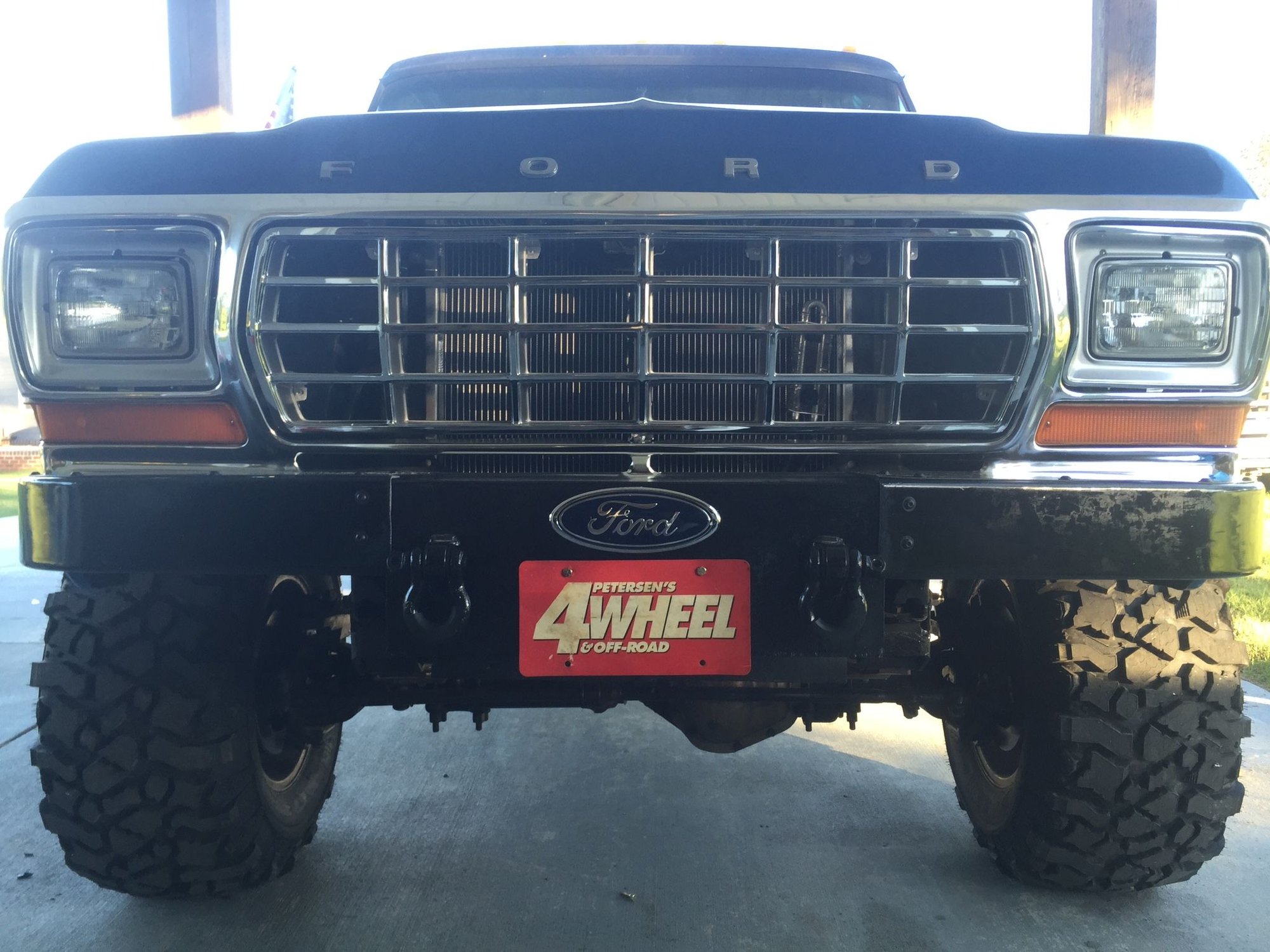

this is how I installed the winch bumper that I built for my 78 F250.
