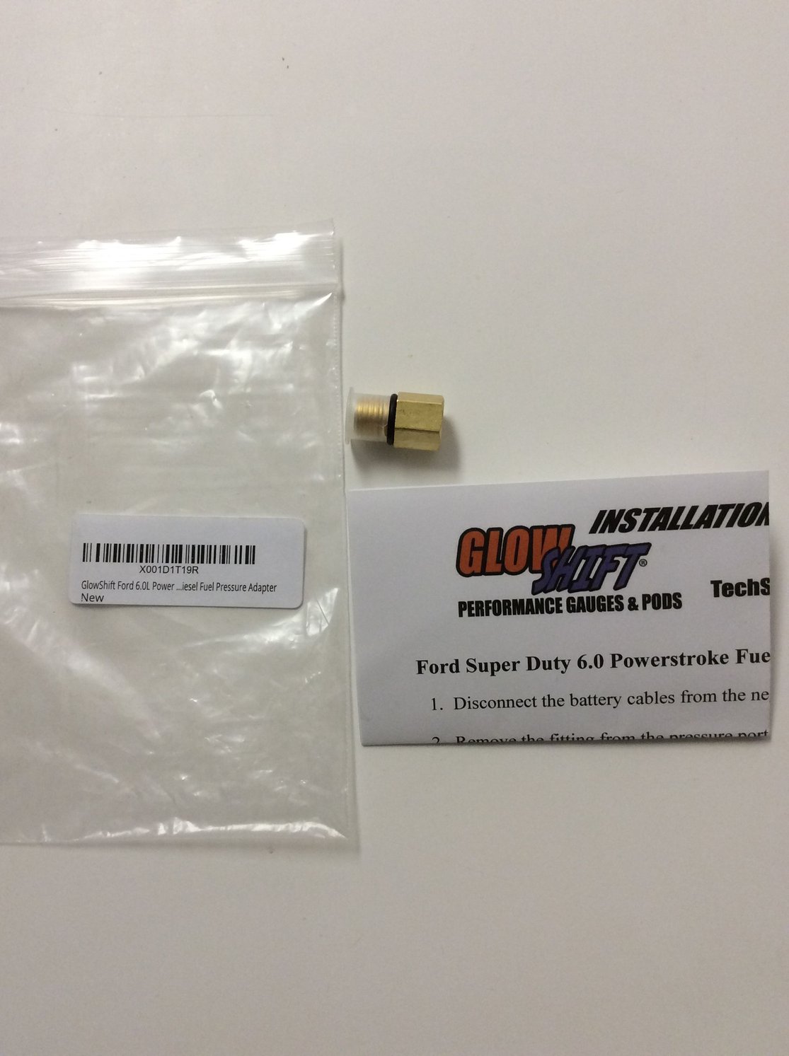

The thread size for the fuel is M12x1.5 male to 1/8 npt female. I wouldn't be really concerned about those temps on a 7% grade in that kind of ambient heat because 50 mph SUCKS on these trucks. Looks like you have an EGR delete, maybe?? I would clear the codes and drive it again, but looks like you have a couple of suspect injectors.......

Got this off amazon for $14.00 still haven’t installed it but looks like it will work.

That's the exact adapter I used when I installed my fuel pressure gauge - no issues at all
