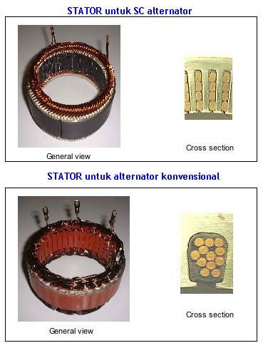

None of the alternators linked in Brian42's post quoted above represent Denso's superior Segmented Conductor technology. The links above are to traditionally designed alternators with traditional windings, that happen to be marketed under the Denso brand, but are not the best rotor stator technology that Denso has developed, which I was referring to and recommending in my previous post.
No doubt the age old axiom "Never judge a book by it's cover" still lingers in our cultural idiom even in this day and age of meandering Millenials. The same adage can be applied to alternators... never judge an alternator by it's case. That is, unless you REALLY know your alternators, and can recognize a case casting by the width of gaps between vent holes, the shape of the vent holes, and other details best left to trivia games for the certifiably insane.
When looking for the best of what Denso has to offer in terms of rotating electrical, it's what is inside that counts. Here is a photo of conductor segmentation, found on a European website, that conveniently illustrates the difference that I have been trying to describe on this forum for the better part of three years now.
As you can see, the power density per cubic millimeter of space is significantly improved with the segmented conductor design, due to the physical efficiency in how the conductors are organized and arranged.
This was the game changing design that Denso delivered to the table at the end of the last century, that first began appearing in production vehicles in 2000 (but not in Ford trucks until 2008).
