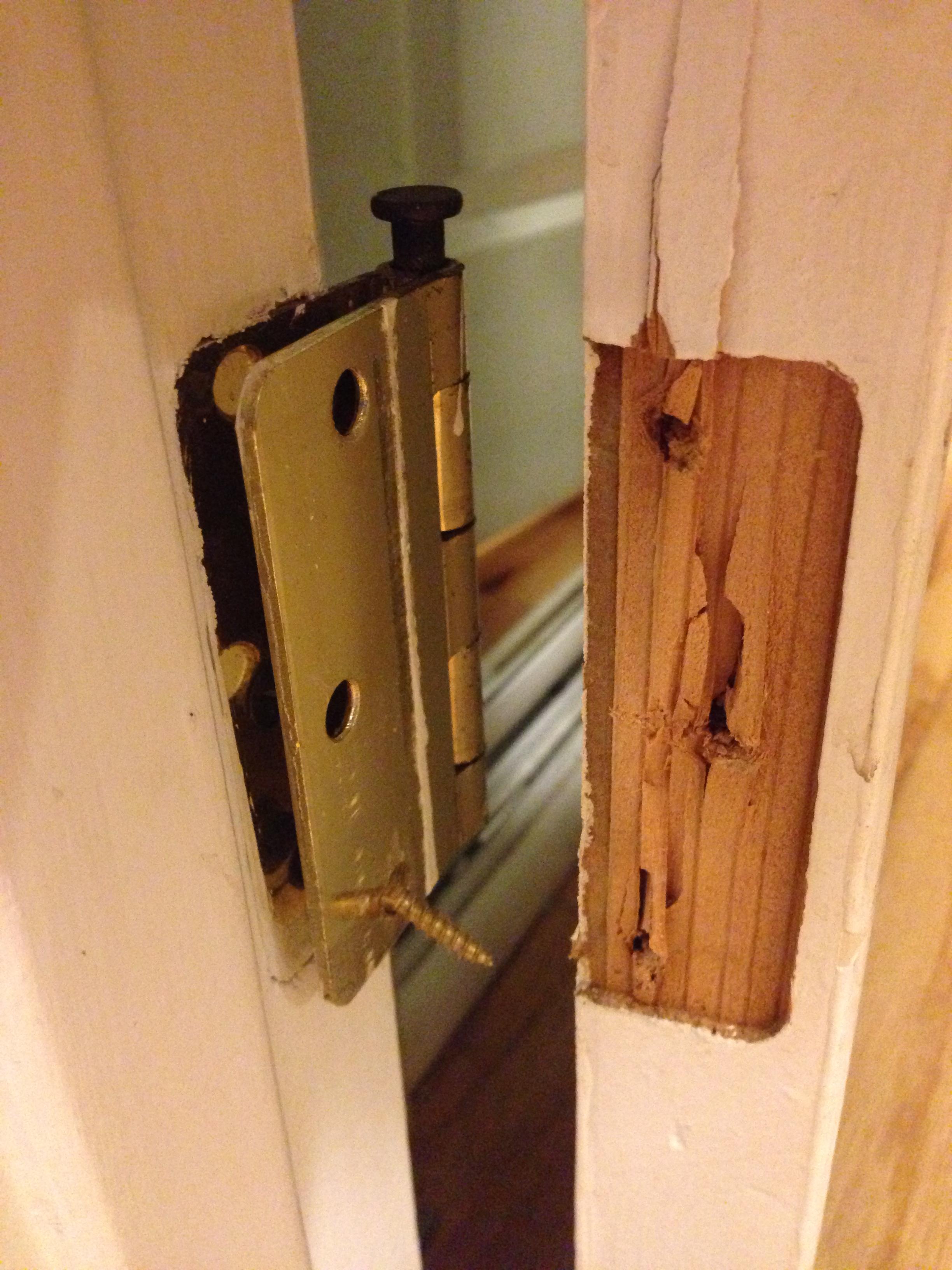

I am not a pro. Just throwing in my 2 cents on what I would do.
\Get a dowel just slightly larger than the hole. Ream the hole a little to smooth it out for fitment. Put a little wood glue in the hole. Tap the dowel into the hole. After glue sets, cut off excess from the dowel. Then drill a new pilot hole and reinstall the hardware.
That is a great trick thank you. Our movers often mess up the door hinges and I keep a couple dowel rods in my truck that I can cut to the length I need.
