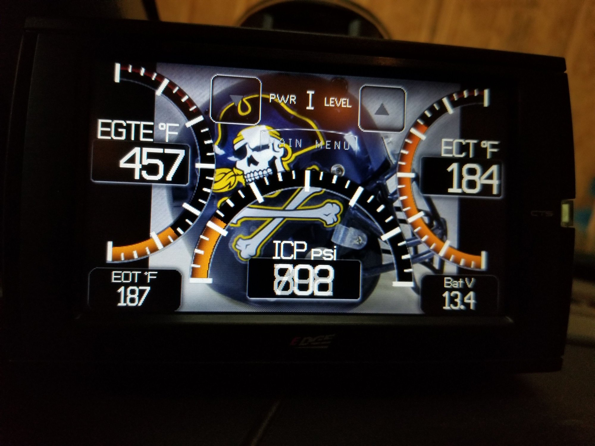

Old Jul 13, 2018 | 07:19 PM
CC'sDad's Avatar
CC'sDad
Joined: Jan 2005
Posts: 151
From: Raleigh, nc, usa
It's around 790
This is warm.

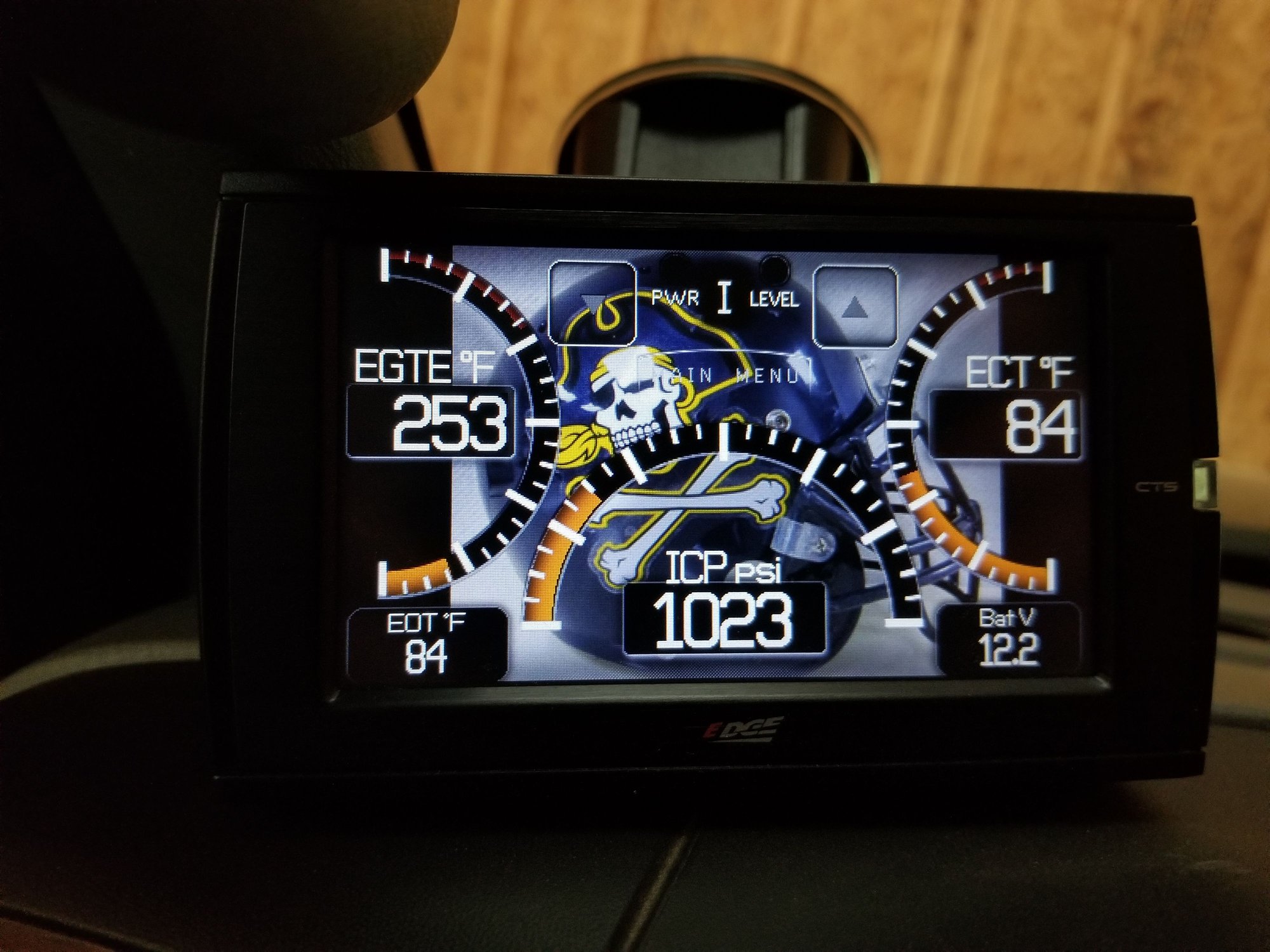

Old Jul 13, 2018 | 07:20 PM
CC'sDad's Avatar
CC'sDad
Joined: Jan 2005
Posts: 151
This is cold.
Old Jul 13, 2018 | 07:24 PM
CC'sDad's Avatar
CC'sDad
Joined: Jan 2005
Posts: 151
Both at idle. I also replaced the icp sensor. Could it be the ipr? Pump? I've heard they never go bad in an 06. Only 200k miles. I did the sct fitting when I replaced the heads a couple months ago.
