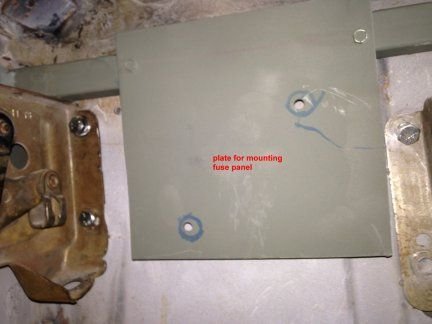

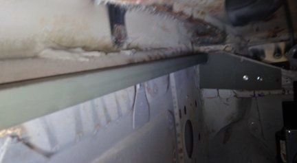

good info here in this thread... here's some other options... this cross piece isn't my original idea, I copied someone else's design and it worked out great
fuse mount plate
cross bar for plate... screwed to kick panel brace

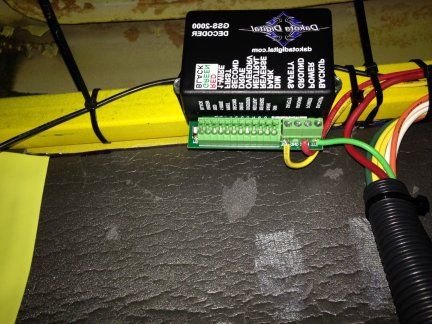

tube used to control wiring and mount accessories, there will be a relay
board mounted here also for the doorlocks
