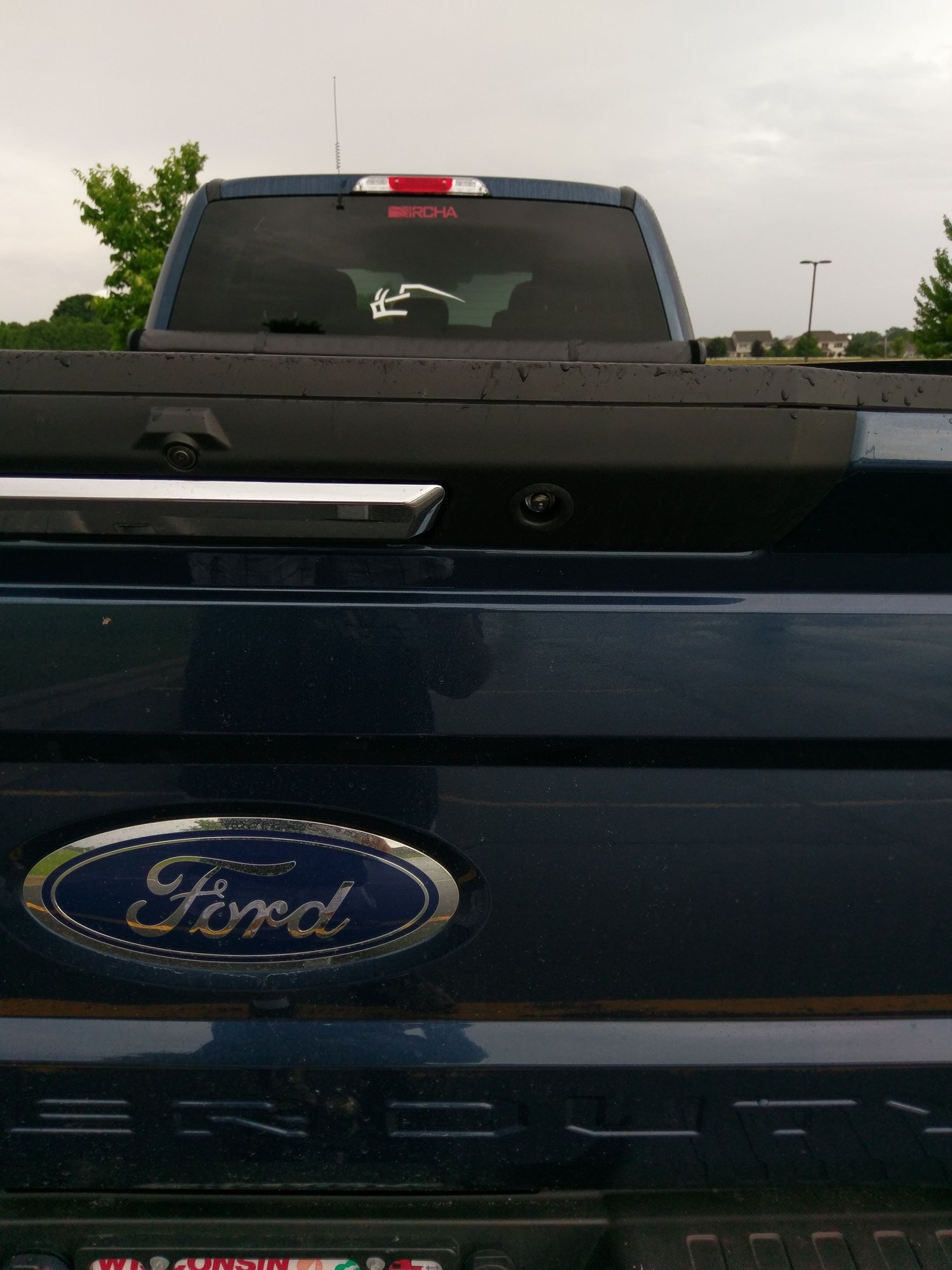

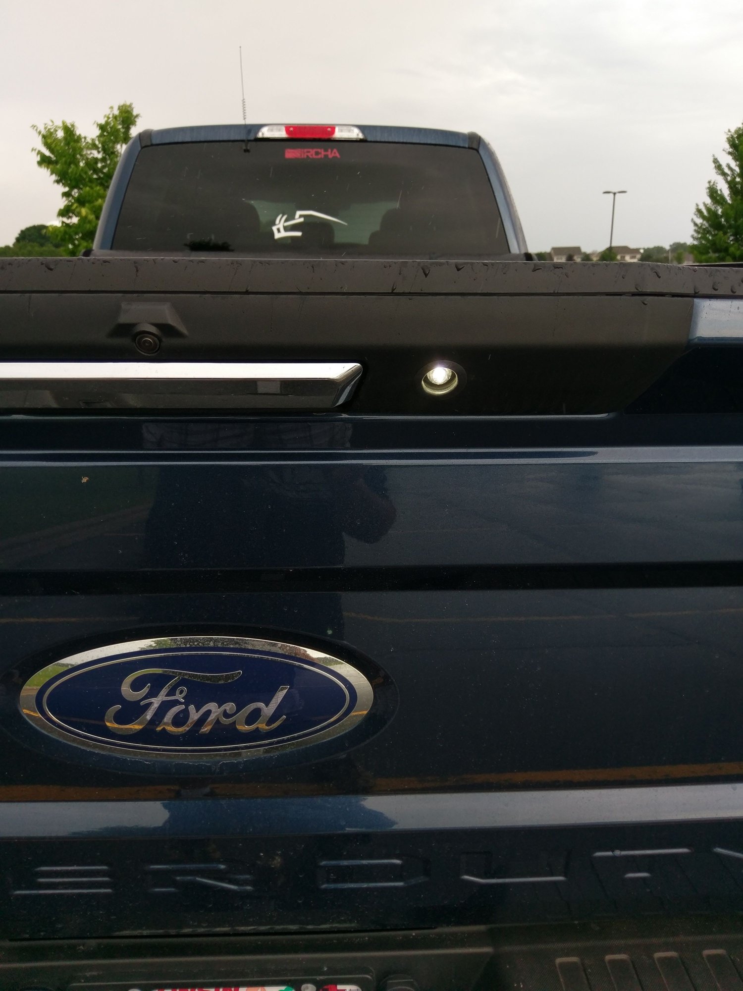

For those that didn't get one of these from Ford (like me), I decided to make my own, (very simple too). LED of your choice, rubber grommet, hole saw and wire it up.

I had a pair of these lights from NAPA (years ago), made by "Trucklite", any light will do to your liking. Run the power wire through the tail gate up to the cab and I tapped into an upfitter switch, negative ground. Took twenty minutes.
