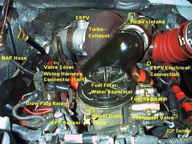

you have a lot of goodies installed
Here is a layout of the parts under the hood to help out
