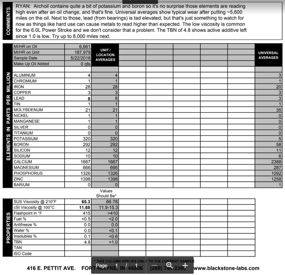

Just got my first oil analysis back. Not sure if anybody has insight beyond what Blackstone commented on. I am running a hot tune as a daily driver so could that be why the elevated lead? In my research it seems pretty mildly elevated. This was with Amsoil Signature 5W-40 run for 6661 miles. Interesting to see the elevated potassium and boron still in there although I did't add any Archoil on this change. The previous oil run was also the Amsoil. and previous to that it was Schaeffers with the Archoil additive.

Schaeffer oil will always give you high lead numbers .........
Remember you retain quite a bit of old oil when doing an oil change. I think the lead is from using the Schaeffer oil

I remember you mentioning that in your analysis. What levels did you have? Will be interesting to see this next one after 2 runs of Amsoil since the Schaeffers.

Mine went as high as 22. Went back to 3-5 pretty quickly. Took 15 oil changes to get back to 1.
