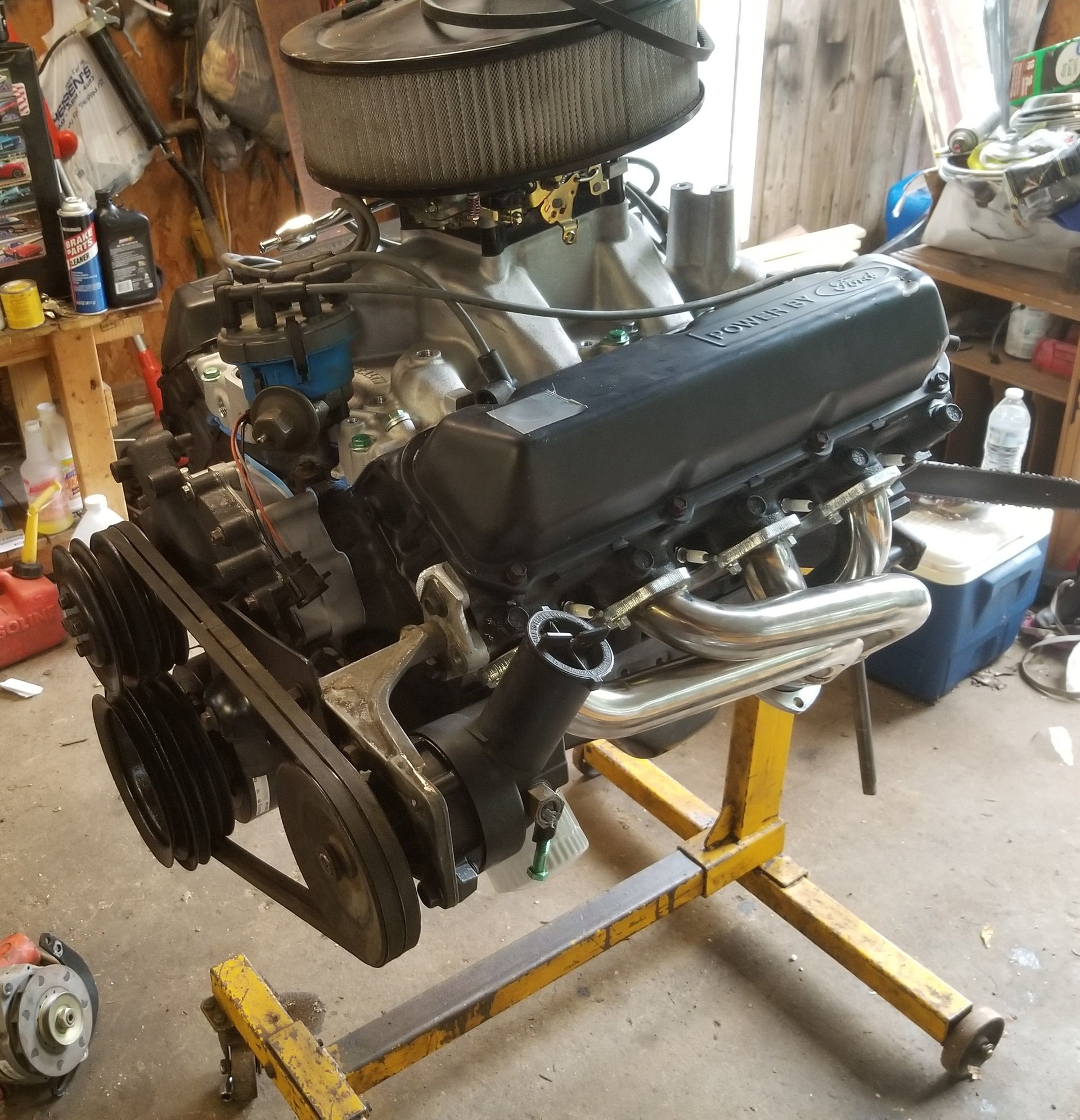

Hi, I'm finally getting down to the nitty gritty on my truck. Firstly I've seen it covered but I can't remember if it was here...the alt brackets for my 460 are car (lincoln) and it sits low. Has anyone got away with running it that way in a 73-79? I've searched for affordable steel truck stuff with no luck. On a separate note, I have a bad cab mount. I ordered one from key parts and it is horrible quality imo. Any suggestions? Do the make a cap to get me by?
