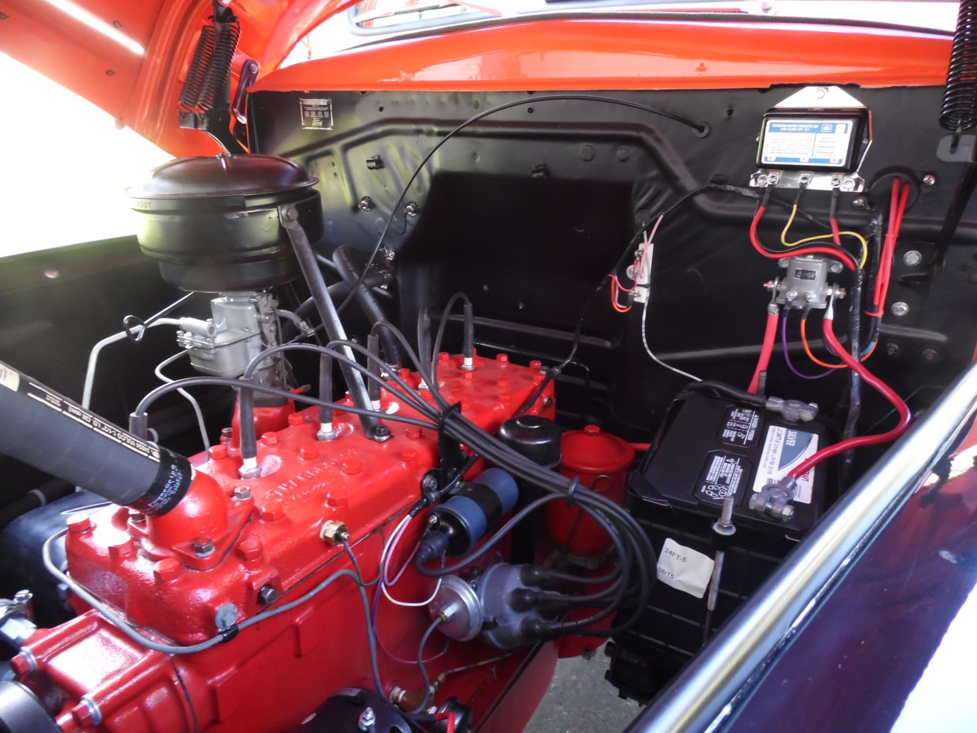

They usually are mounted on the firewall but can be mounted in other places. I suspect you don't have one since your original coil did not require it. If you are using a ballast resister, you must have the wiring to support it including a starter solenoid that has the connection to bypass the resistor when starting. Here is a picture of a ballast mount on the firewall (white ceramic device). Note the starter solenoid has four terminals (one on each side and two in front) with the right hand front terminal being the bypass circuit.
