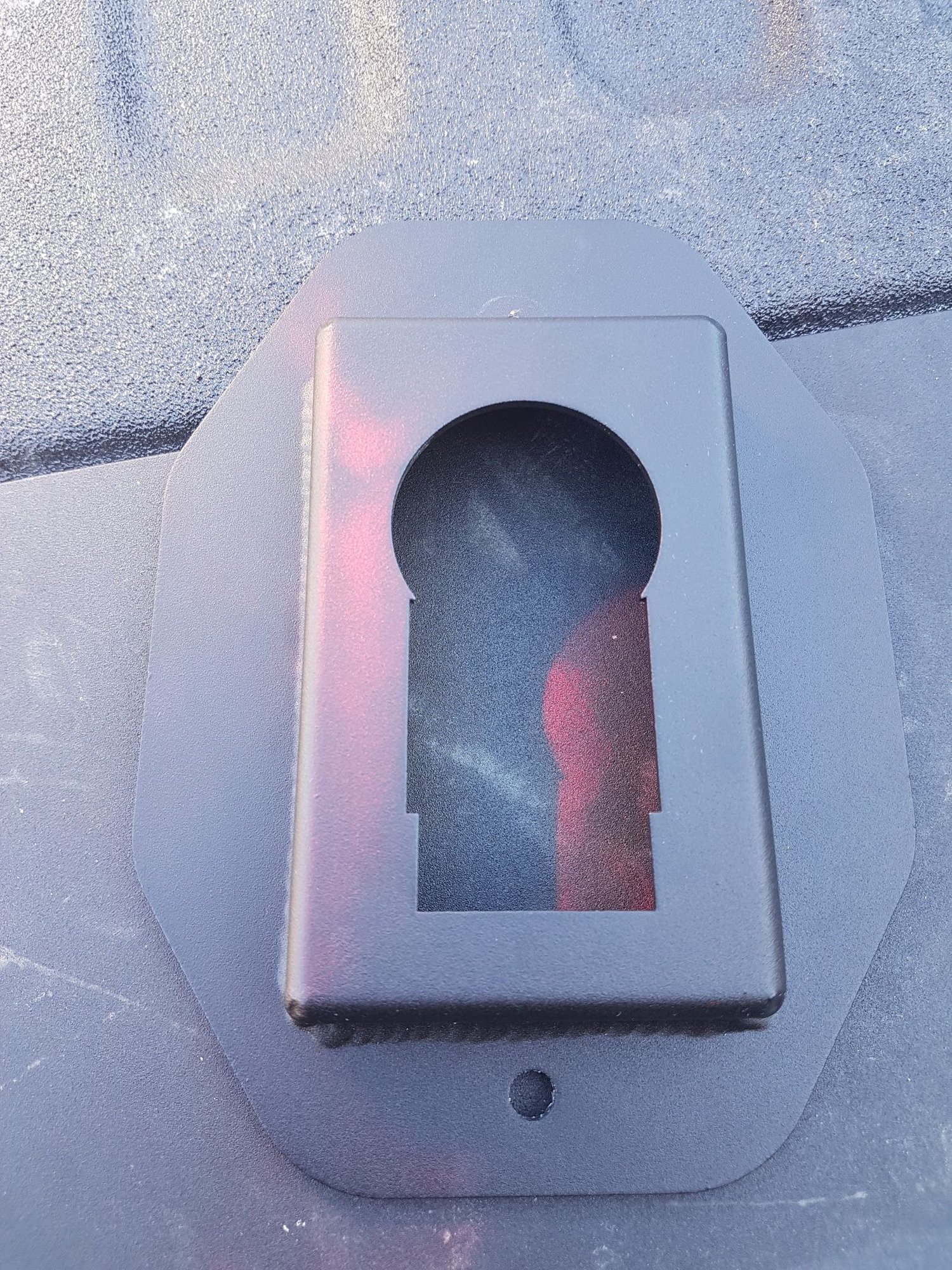

This is the Plug housing...

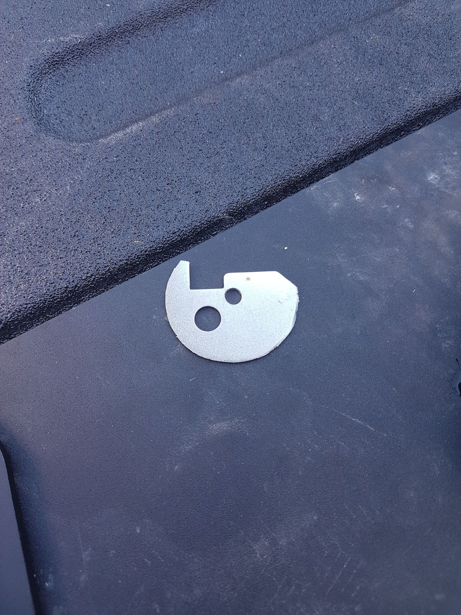

I was a little leery about drilling but the instructions were spot on and it was really easy mode. Below is the piece cut out.
This is the opening once everything is cut and ready to go. I used some touch up paint where there was bare metal from drilling and I also sprayed the bolt clips as they are steel. (I've seen some pics of those clips rusting and making a mess.
As well you can see where the factory plug was, its not exactly water tight or dust proof.
All that was left was to plug the harness into the plugs and bolt it in place.

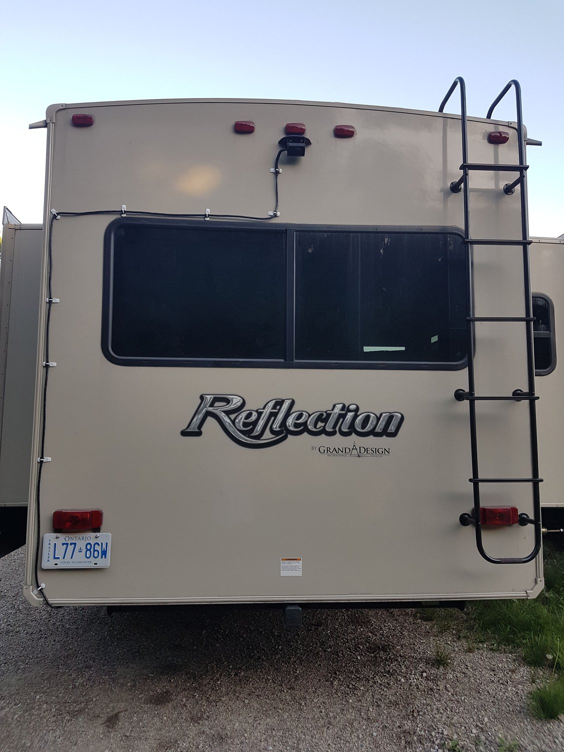

So here is the before and after pics. The first set is from the dealer install. Note the 3m Command strips on the rear. On the front, the bungee cords were meant to hold up the cable from the trailer to the plug in the bumper so it didn't drag on the ground.
Now here is the After, I used the Nichol's extension and ran the plug up through the front of the 5th wheel and brought it out by the kingpin. On the rear I ran the wire across to the ladder and used cable wrap to go down the ladder. Much less conspicuous.
Really happy with the outcome.

I hope the didn't charge you for that mess, much more professional looking. Camera while driving? Trick it into thinking it's in reverse?
