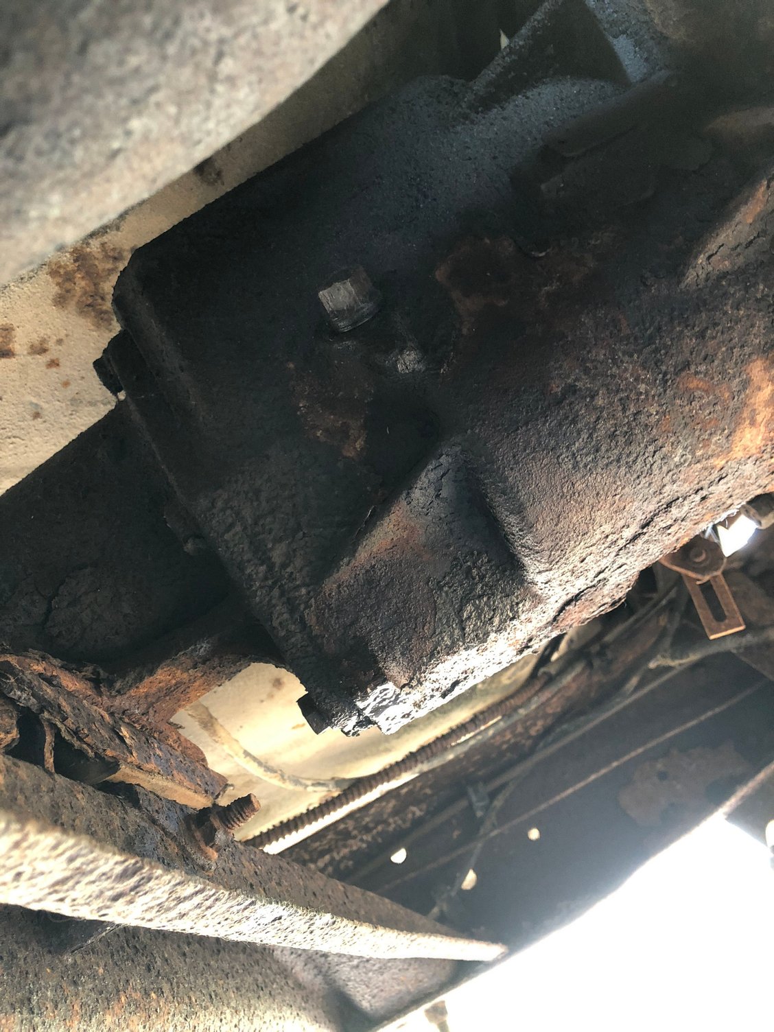

When I changed the fluid on my 3 speed manual trans, there were 5 bolts that held the tail housing to the gearbox. The 5th bolt is at the very bottom and when removed allows at least most of the fluid to drain. It’s the one pictured that’s close to the trans crossmember. Have a large pan ready because it will likely drip from that crossmember.

Thanks for the responses guys. I'll get it done by taking those 5 bolts out tomorrow morning and let you know how it goes

Just do the bottom, it's lowest point. No drain, Ford must have save like 4 cents by not drilling, tapping and a plug. It made it past warranty over 35 years ago they knew they didn't need to drain.
