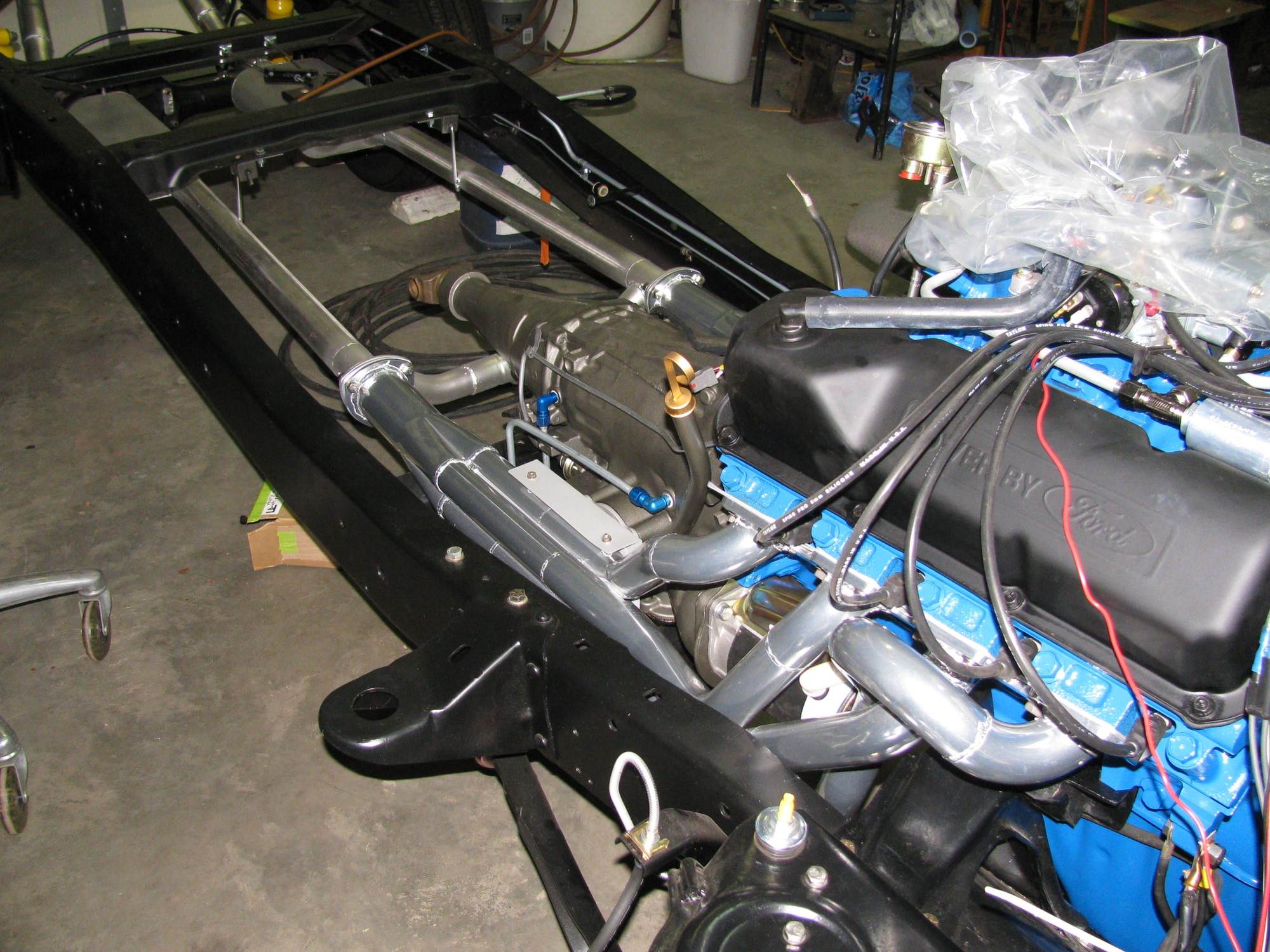

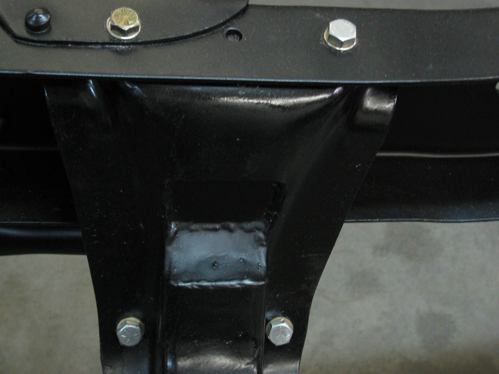

You can flatten a header tube up to 1\3 of it's diameter without affecting the flow. I had to build my own headers from a box of bending mistakes because no one makes a long tube for 4 barrel Cleveland heads in one of these trucks. I ended up with more money in having them coated than in the headers themselves. But I did have to notch the cross member for more clearance and make a heat shield to keep the heat off of the servo on my C6. The exhaust is a Summit Racing kit. It comes with plenty of tube and bends.

Crop duster, man it would be nice to have the body off to install the exhaust :-) Is that a heat shield you added next to the transmission?

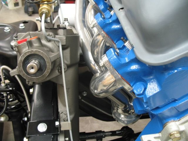

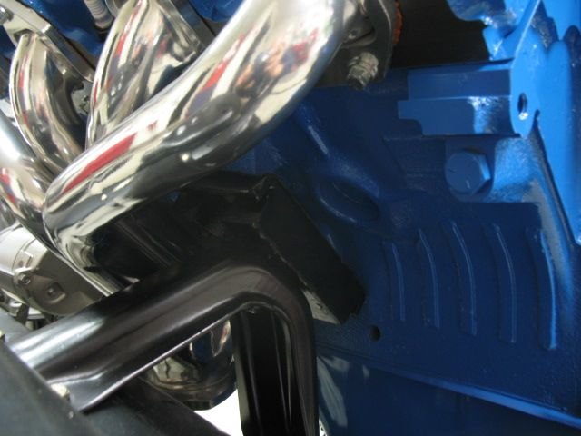

FF427, yes those are the ones. Yes, they do set close to the block. Take into consideration the 'slant' of the exhaust ports when the heads are bolted on the block. There is a member on this forum that might be willing to post some pics of his for you. He monitors this board, if he wishes, he will.

...as requested....at 3:00 AM?...get some sleep!!

Resonateur, Thanks for the pictures, I ended up just grinding about 1/8 in off the cross-member, I know some here will cringe at that but there was still plenty of material there in the lip.
