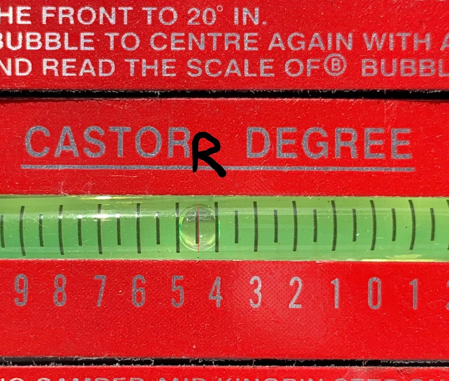

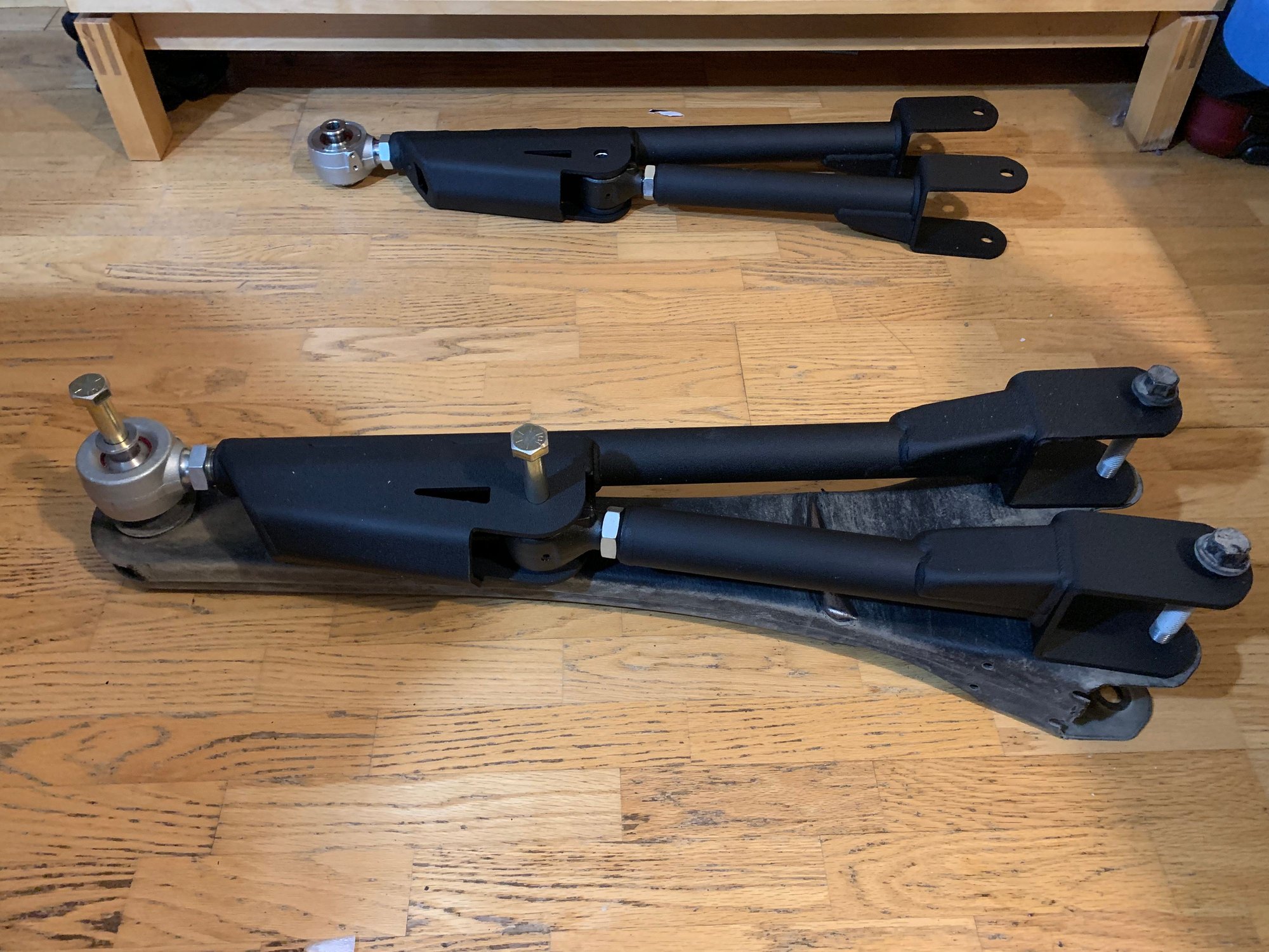

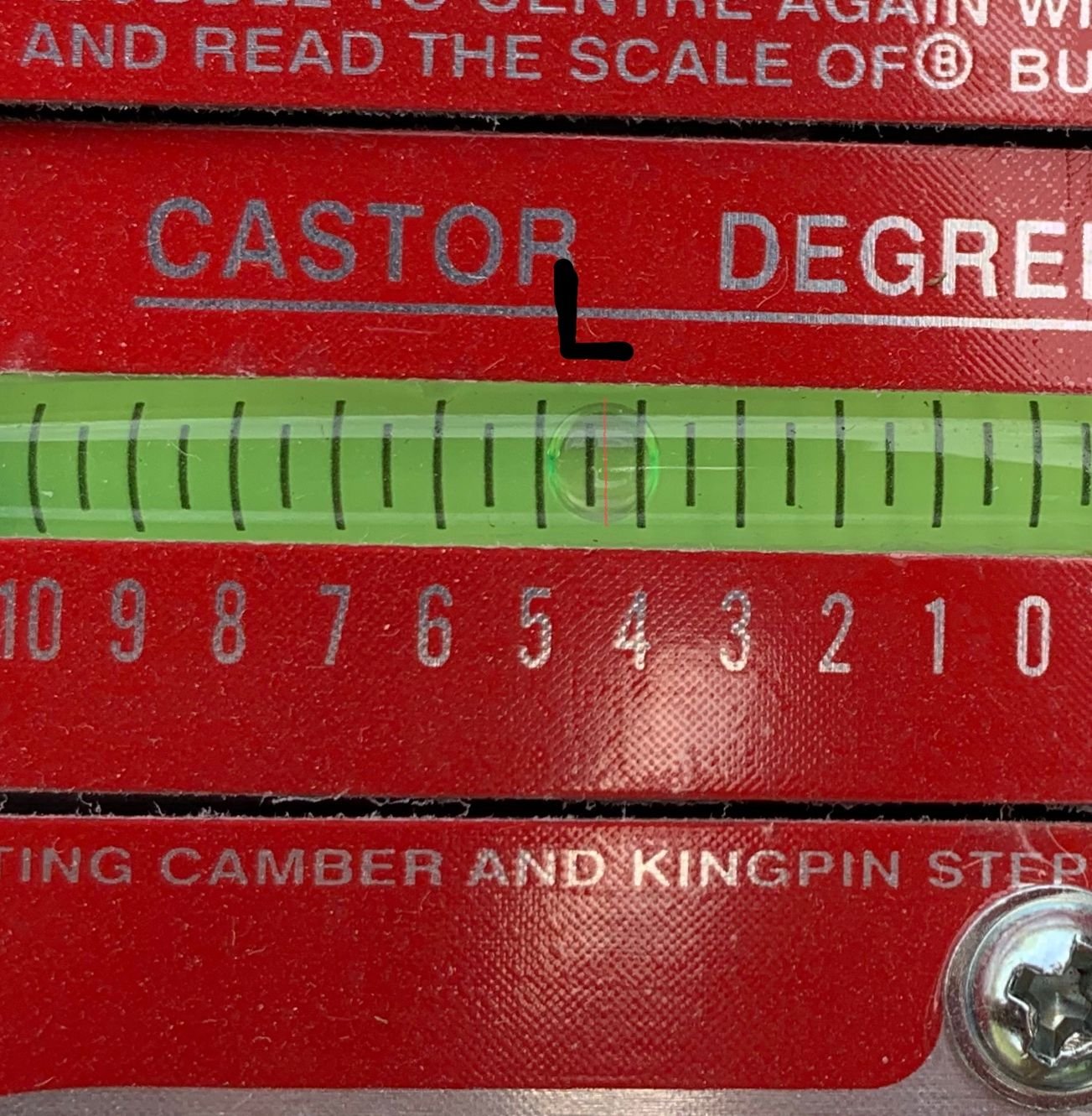

I have PMF adjustable arms and no lift. The caster increase in the least adjusted position was .25 degrees.
Stock caster
Stock caster
Difference in arm at most closed position
Caster after radius arm
