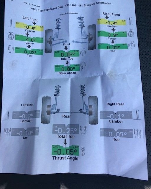

HERE IS THE SHEET THEY GAVE ME.....

no I appreciate it. It definitely cleared it up. So with my picture above I need a 1* caster to fix my issue correct? On both sides or just one?
no I appreciate it. It definitely cleared it up. So with my picture above I need a 1* caster to fix my issue correct? On both sides or just one?[/QUOTE]
You are pretty far off, you are on the inside of that caster valley and you really should be over on the other side. The Moog adjustables might be the right option for you? I've never used them myself but they would allow you to put 2* on the left and 1-1.2* on the right. Honestly, a good alignment shop should be able to do this for pretty cheap. Just let them know you want the left to be around 3.6* and the right for whatever they do for crown around your parts.

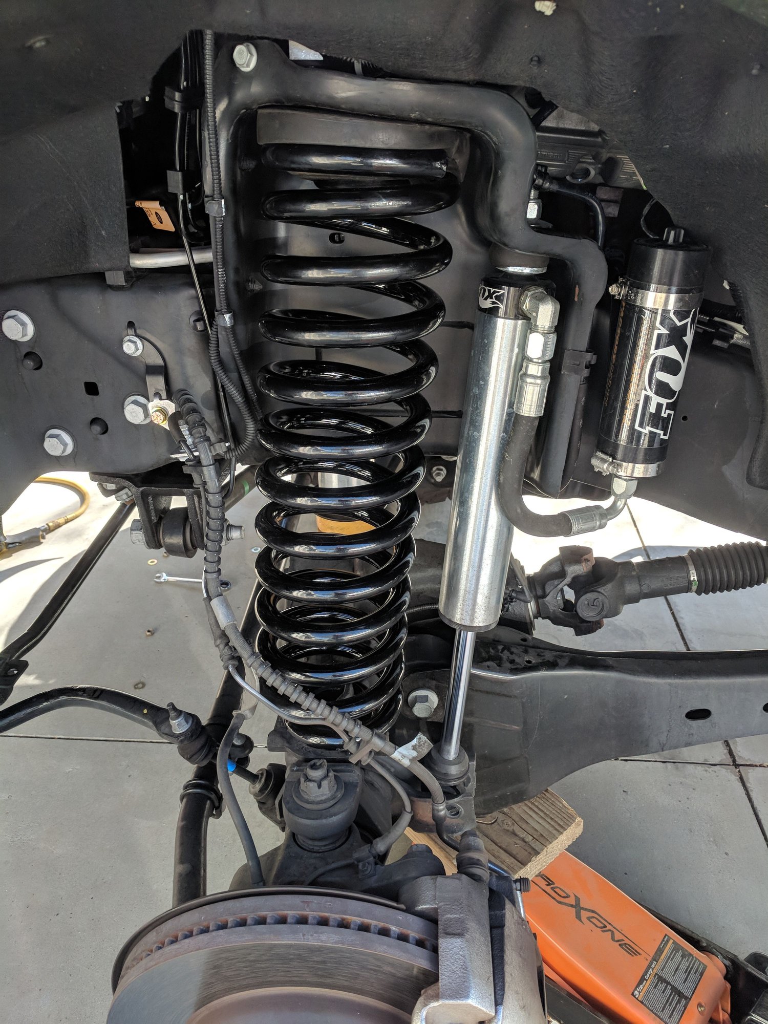

This may help some out there. 2018 F250 with 2.5" Carli and dual fox stabilizers. My truck drives great with no pulling.
