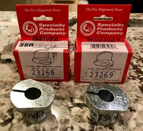

I had these installed. Recommended by ReadyLift. This plus the Fox steering stabilizer made it track straight & tight. They’re different on the driver & passenger side.
i have a 5” rancho RA lift. I have had the same issues for a year with ultra light steering and pulls to whichever direction the crown is. My caster was at 4.7 left and 5.1 right with the OEM caster sleeves in. I installeded these and now I am at 2.5 left 3.2 right. Light and day difference. I should have done it sooner. Tight steering and holds the road on either crown now.

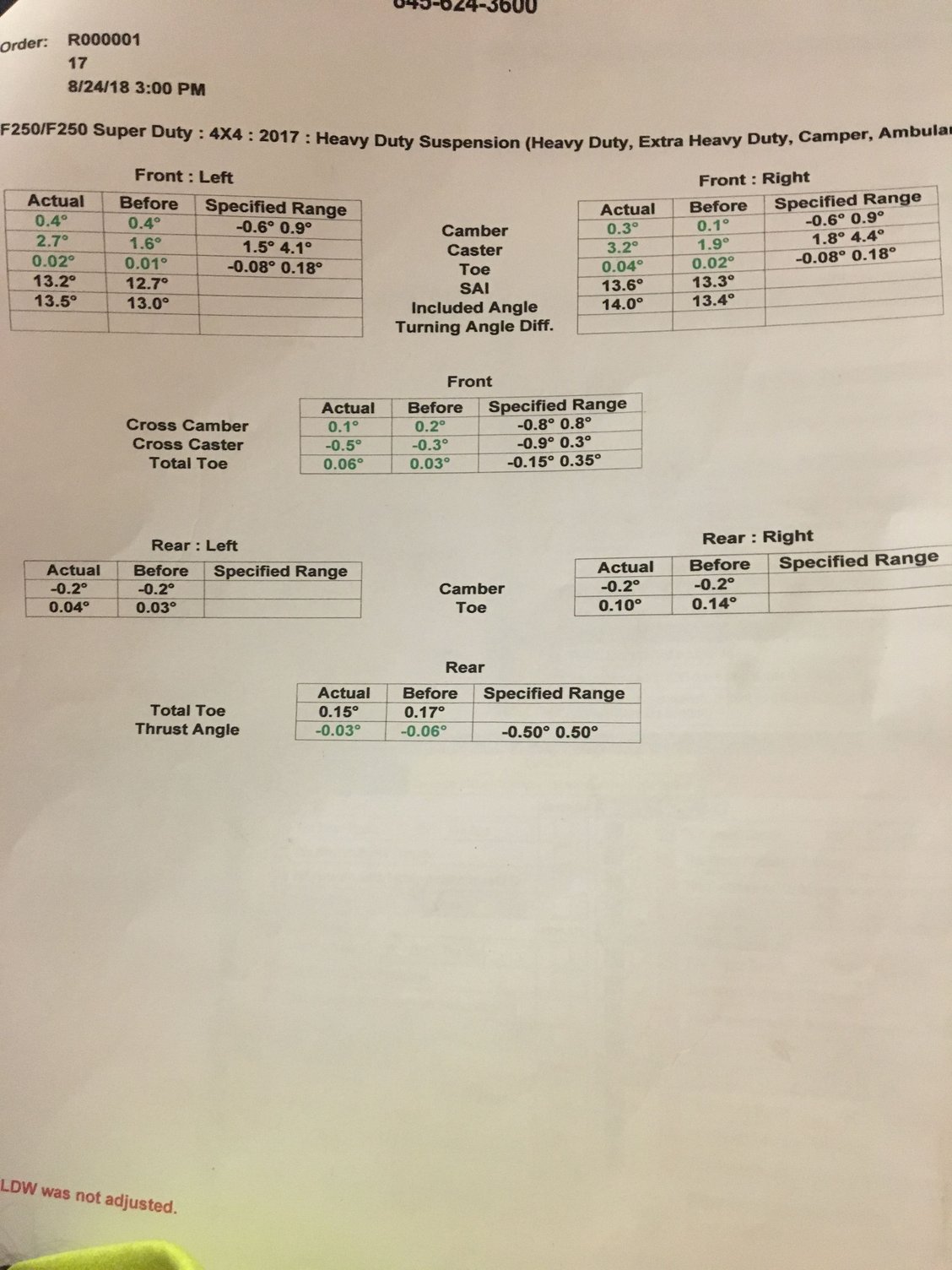

So after having ford install these shims it’s still pulling and not driving straight these are the specs they gave me before and after with shims any ideas on what to do or what other shims to get ?
