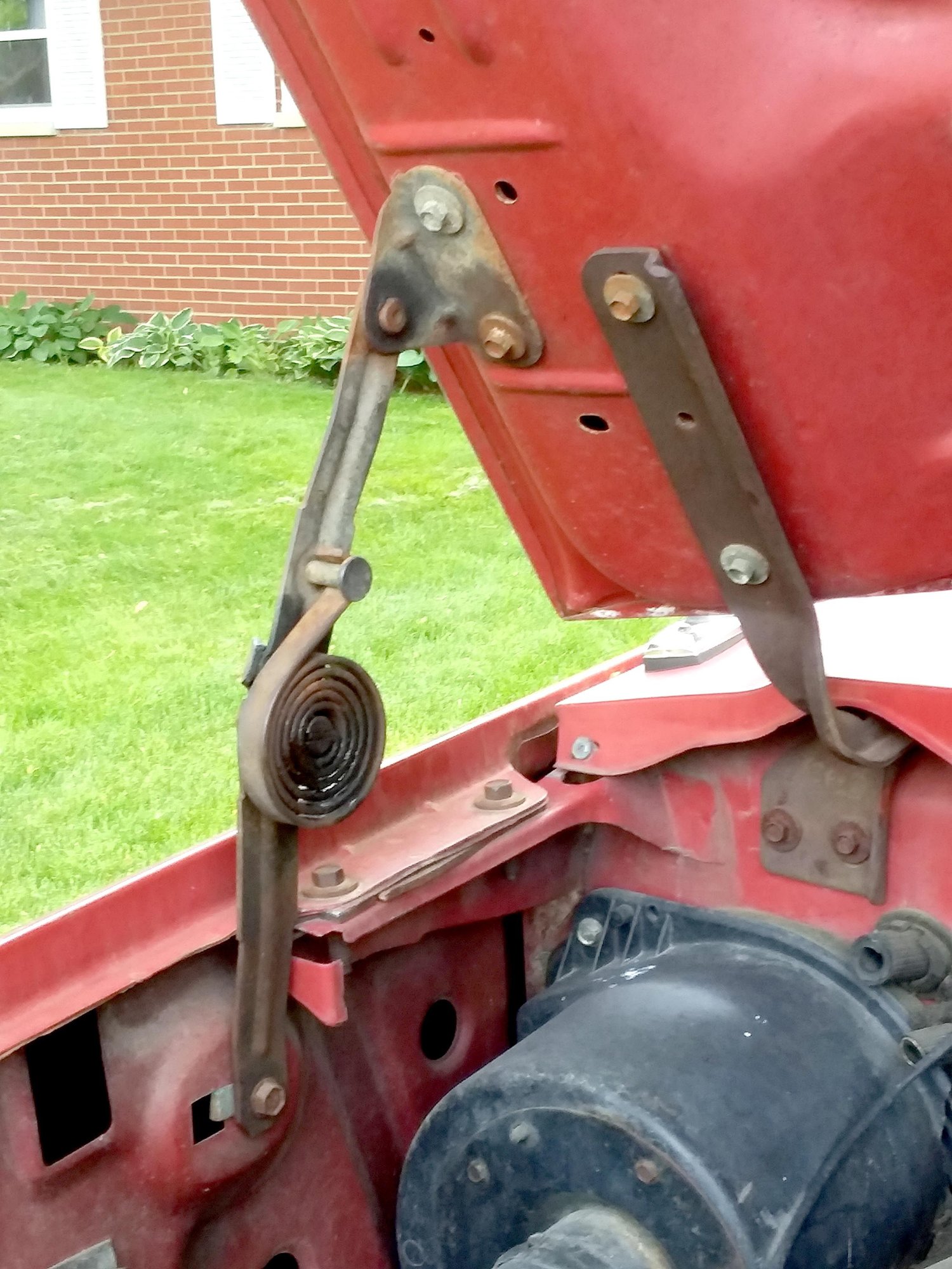

I am attaching a photo of the spring in question. I understand that just unbolting it will not result in it uncoiling and will stay in place and allow me to attach the new hood to both springs?
Left hood spring

It won't uncoil, you will be fine. If you're paranoid, disconnect the single bolt down on the fender just to gain some confidence.
