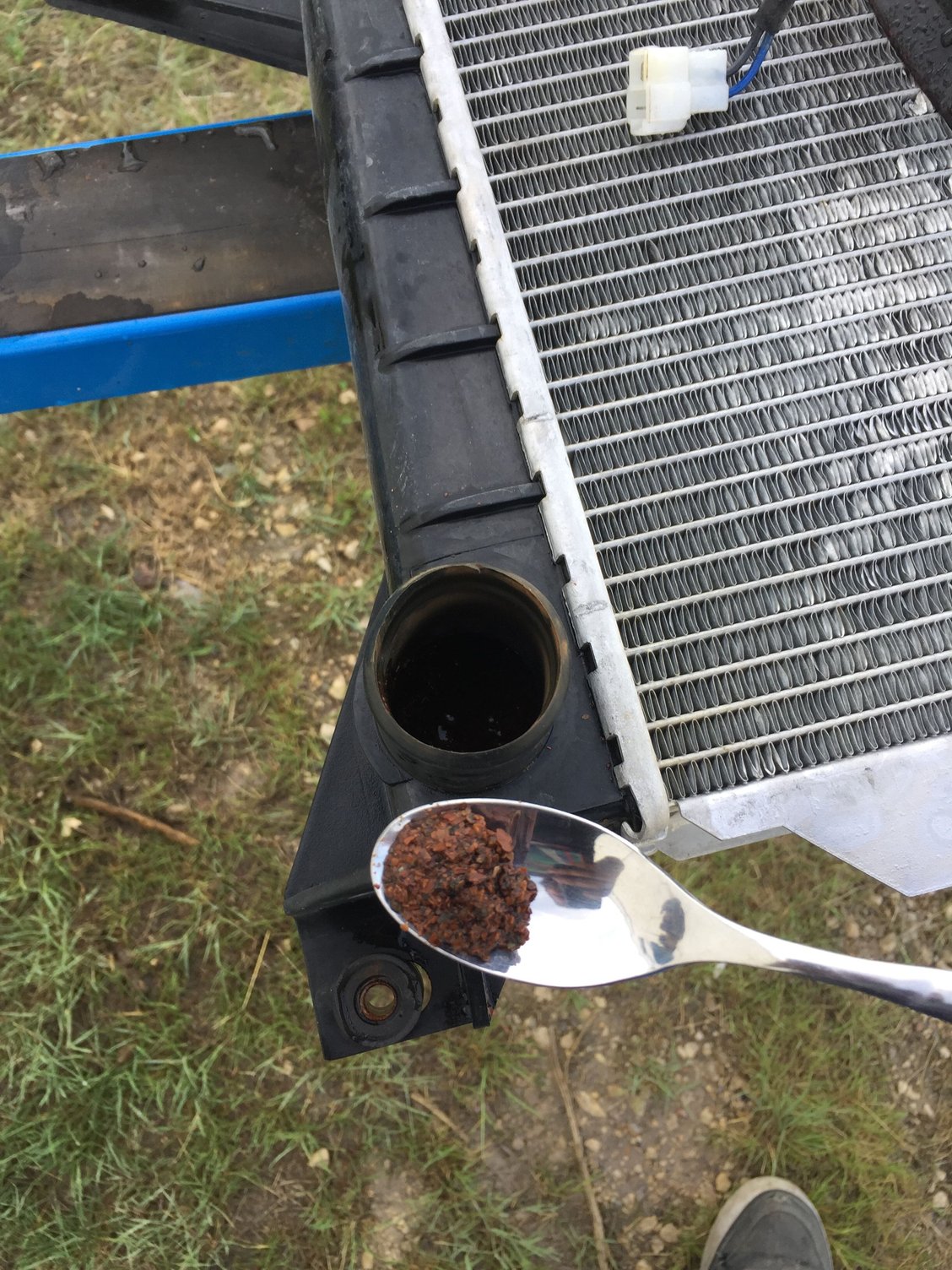

Well I ripped everything apart today minus the water pump and I found a lot of sediment in my rad. Probably over a hand full came out. And that’s just what I dug out by hand never mind what my garden hose flushed out.
I have a fail safe thermostat and it did it’s job it was pined wide open and stuck there. I’m going to put ITV all back together tomorrow and run it with some distilled water and dump it and refill properly. I’m also going to try to make a temporary filter for the upper rad hose to catch what ever else is stuck in there.

So you are intermittently plugging things up due to the sediment. No heat from the heater means no flow. You already know you must get that cleaned up. Are you taking out the block drain plug(s) when you flush? My son's 95 F150 had a similar problem, I had to eventually replace the radiator as repeated flushings just could not get all the crud out.

Yeah I gave it a pretty aggressive flush a few months ago and I think that loosens things up. I’m going to put it together tonight and flush it with distilled water. I tried to drain the block but I stripped the bolt. I might try again tonight to get it off

Looks to me like someone used Bar's Leak on it and overdid it a bit.

I pull the t-stat and replace housing with a tempoary cardboard gasket. Also, pull the radiator and heater hoses off the block. I would flush each and every hose in both directions till clear. I would also flush the block in both directions till clear.
