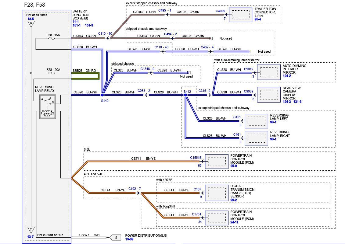

I have a 23 foot 2013 Thor RV on a 2013 E350 Chassis that we are installing a Navigation system with an integrated backup camera in. Has anyone made the reverse light connection under the dash? We have looked on line and have gotten different locations for getting it, but it doesn't seem to match what we have. Does anyone have a suggestion as to what wire and the location?

These are from a 2014 but ought to be the same as 2013. Also check for connector C315 in the B pillar for a blue with white stripe wire if you can not find it under the left side of the dash.
