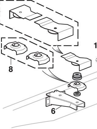

The metal piece in bj's pic appears to me to be a repair patch for the cab mount area . My floor is solid and there doesn't appear to have been anything removed from the area as I'm sure the metal section would have had to have been welded .

No that piece is not a repair patch, it's a part of the complete mounting system....it is a re-enforcing plate that fits up tight to the floor

Hard to tell how high that is without seeing from the side , but it's starting to make sense why the PO had a huge stack of washers in there . Are the plates with washers " they appear to be spot welded already " available separately or am I back in manufacturing mode ?
That little dog leg fits the contour of the floor pan..

That picture is from MidFifty. And Yes they are spot welded into the floor and kick panel.
1953-56 Ford F-100 Front Cab Mount Kit With Plates

in some Cataloque pictures it looks like the lower small rubber pad belongs on top of the wing below the retainer. On other pics it says the lower small rubber pad belongs underneath the "wing" !?
Since it is years ago when i took my Truck apart i´m not sure, but i mean to remember underneath the wing was a just square 2x2" rubber and just a washer. The lower small rubber pad was above the wing underneath the retainer.
If that lower small rubber pad belongs underneath the wing than there is nothing between retainer and wing? Metal on metal (Retainer directly on the Wing) is not a good idea, it will cause corrosion and noise.
Other than that i would say the lower small rubber pad doesn´t fit really well underneath the wing...
how did you folks assemble the front cab mounts?

Just like in the illustration except the metal piece between the rubber gets a quarter turn..
