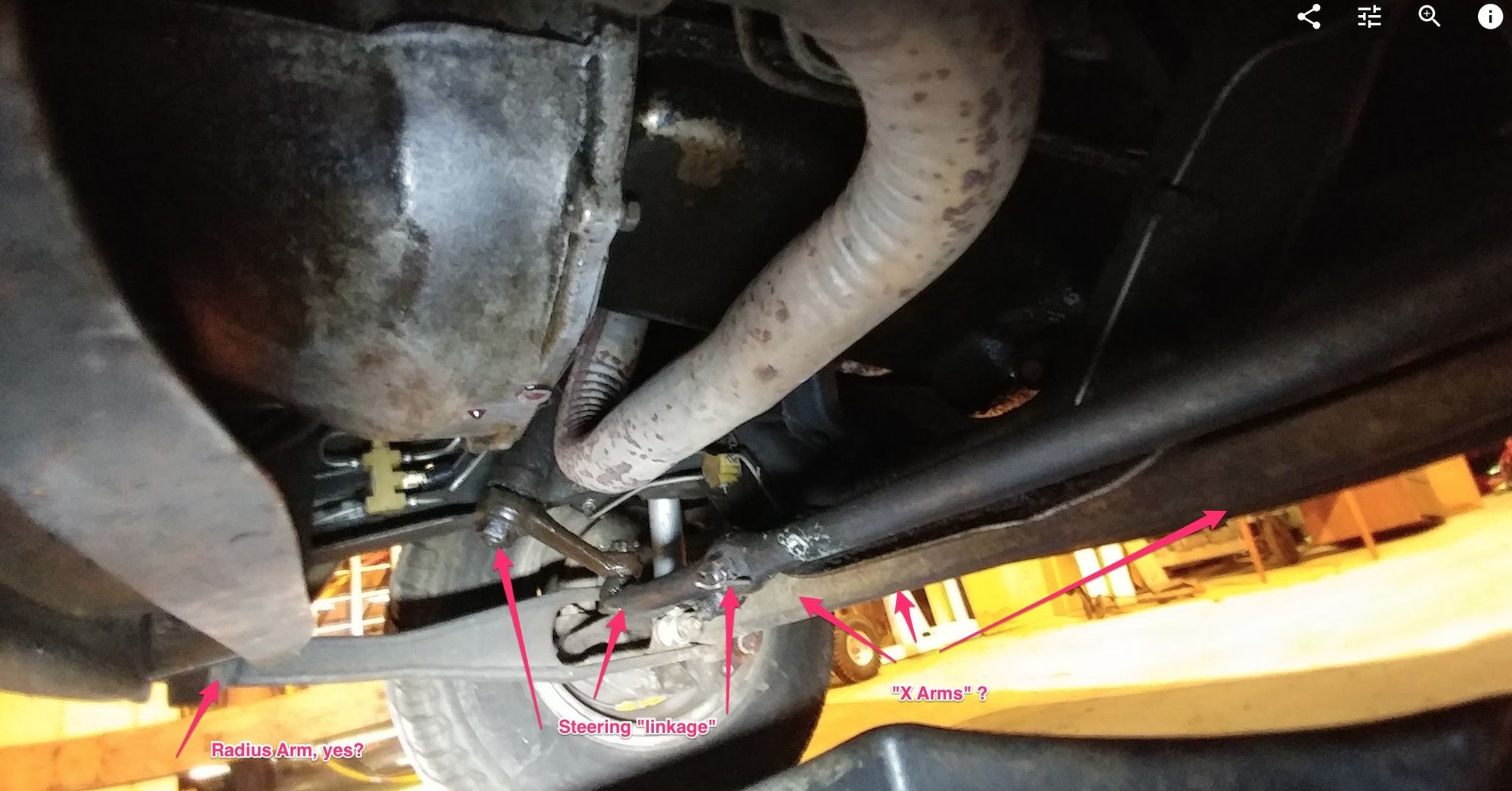

Everything is worn, cracked and dry. I am browsing RockAuto right now trying to figure out what I have. Here is a crappy pic of what I think I see..
The tie-rod ends actually look ok. Everything else, including body mounts, are trash. Could someone help with any sort of name, part number, link, etc to each thing? I am fairly sure I have the flexomatic rear suspension (has the tab/tongue on the top of the spring that isn't touching... I think it might need a rubber pad). It's a 302 motor I think and a C6 transmission, automatic. It's 4x2 and I think I recall it saying "custom cab" or something on it. It has straight sides. If I can provide any more info let me know! I am buying other stuff from Rock Auto so bonus points if someone points me to the proper items there. I have someone at Prothanesuspensionparts.com also helping get me advice but doesn't hurt to get more!

I see a pitman arm at the steering box. It is connected to the daglink. You X-arms are the I-beams in the twin I-beams. If you have a have a 302 then you have a c4 trans.

Originally Posted by whodkne
1969 F250 2WD
It's a 302 motor I think and a C6 transmission. It's 4x2 and I think I recall it saying "custom cab" or something on it. It has straight sides.
No F250 came with a 302 until 1980. 302: 1969/79 F100 & 1975/79 F150 only.
No 302 was available w/a C6 until 1978.
1968/72 F250 would have come w/a 240 or 300 I-6 with a C4 or 360 or 390 with a C6.
4th digit of the VIN is the engine code = 1968/72 F250: A = 240 I-6; B = 300 I-6; H = 390 2V; Y = 360 2V
C4's have 11 trans pan bolt holes, C6's have 17.

Thanks! According to the VIN at least it is a 390 with a C6. Definitely a C6 but the previous owner (well, the person selling it for the owner) thought the engine was replaced so I'm not 100% sure that is what is in there. If anyone can confirm or tell me what to easily look for I will.
Otherwise, still would love to know what bushings I need all around, here is what I think I know:
Radius Arm
https://www.rockauto.com/en/moreinfo...888&cc=1495113
I-Beam (do I need two? seems like the pics only indicate one and I think there would be one on each side?)
https://www.rockauto.com/en/moreinfo...495113&jsn=484
Cab/frame mounting (can't seem to find this at Rock Auto)
Cab Frame Mounting Kit | Dennis Carpenter Ford Restoration Parts
I don't seem to have a "sway bar" at all, so no bushings for that. I think the flexomatic suspension should have some bump stop on it, I think I read. I can't find that at all in any catalog.
The tie rod ends look decent so I think I can leave those.
No factory sway bars until 1973.
Pic: 1968/72 F100/250 2WD with Flex-O-Matic
