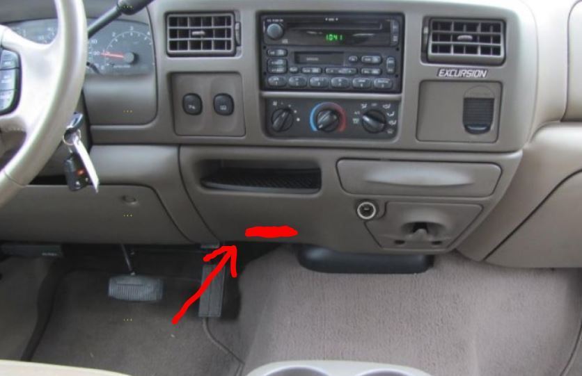

I and a lot of other folks have mounted theirs here. I don't have a pic of mine. The bracket allows enough pivot to get it relatively close to parallel, but still sloped a bit. The P3 works just fine on any angle, according to the instructions, along as it is facing the correct forward direction and not slanted side to side.

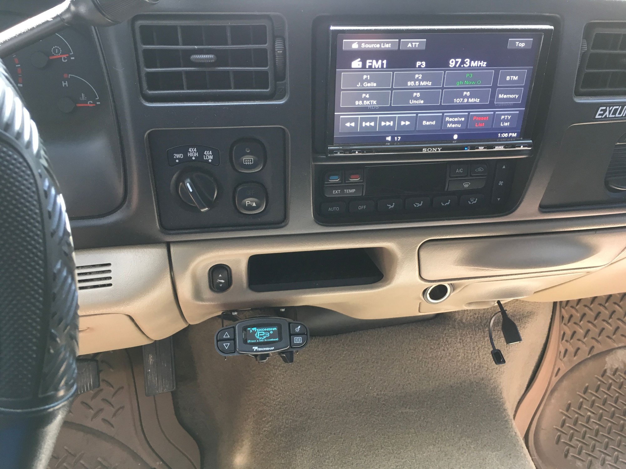

Here's how mine is mounted. Works well. Angle is just right to see from driving position. Buttons are easy to reach if you need to make adjustments.

Just to add to the pile, my P3 is mounted just like as shown above, over 35K heavy towing mikes without a hiccup, works excellent!

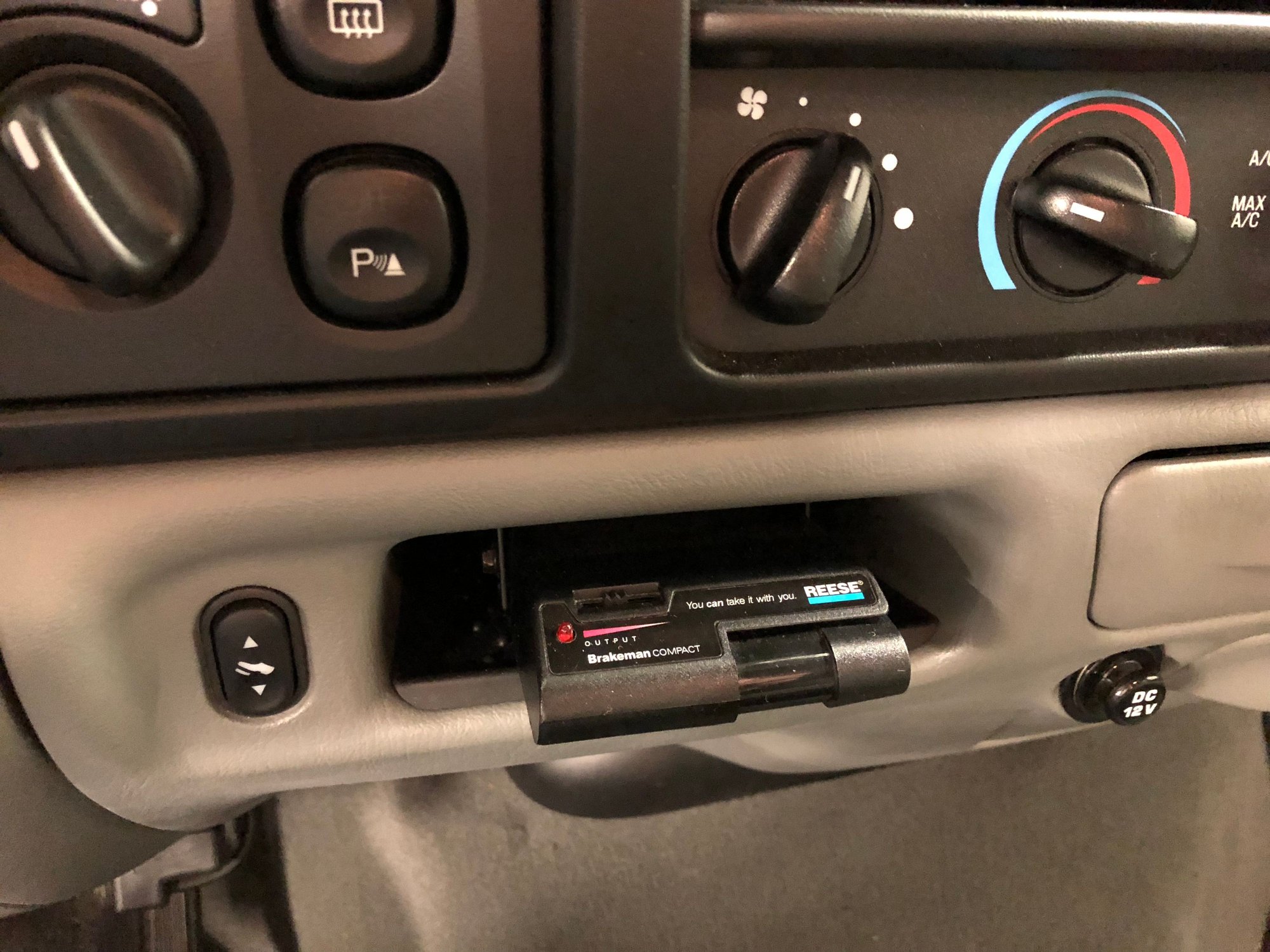

The controller in my 2005 is...well....the same vintage as the Ex, and it’s mounted in the cubby.

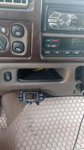

my P3 is mounted as shown and it works perfectly. I use it with my Big Tex 14TL-20BK tilt bed equipment trailer 20’. Installation was very simple since I also purchased the 3035-P wiring harness.
