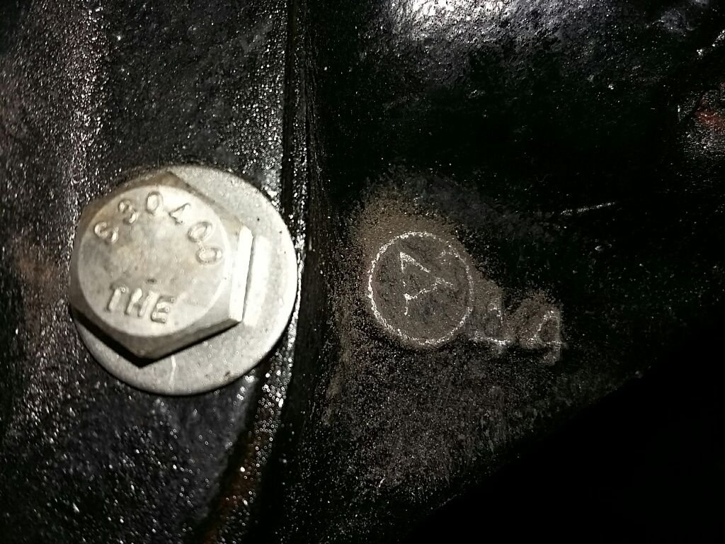

Yes, that's exactly right. I do not know if it is the axle originally fitted when built new. The stamping in the circle you mentioned in your first post....does that apply to the 41 and the 44 axles ?. I will get under tomorrow morning with a torch (sorry...flashlight), and see if I can read the casting text. Either way, I can see why people tell me it is far more cost effective to do an axle swap rather than change diff ratios. BUT I will still get some prices for crown,pinion and carrier. The downfall will be the cost of shipping and taxes to UK. I will let you know what I find tomorrow.
OK
, been under the truck doing some investigating. Here is a photo of the text in the area circled in the earlier post. Above that their are some numbers 18419. Also I marked one wheel with tape and also marked the propshaft UJ and diff casing. Spinning one rear wheel one complete turn makes the propshaft turn just shy of two complete turns. What does that tell us ?.

This morning I tested with both wheels off the ground. When I turned one wheel, the other did not turn. This makes it a posi/lsd ?. On the article I read if this is correct....it said to test with both wheels free. Anyone else confirm the test please.
