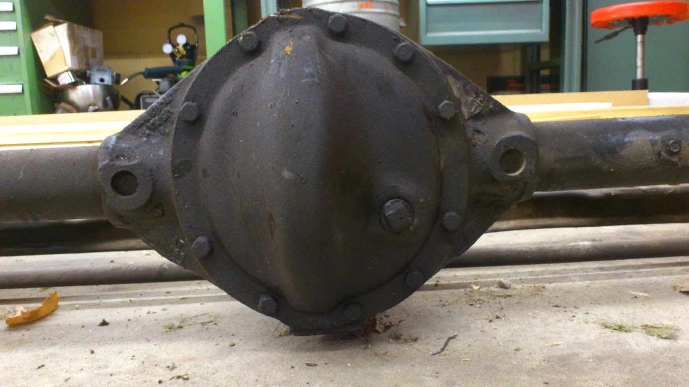

A picture of the rear of the differential housing would help us determine what model of axle you have. If we're talking about the truck in your avatar picture, then it's likely a Dana 41 or a Dana 44 depending upon the where and exactly when it was built. Again, a picture of the rear of it will help us determine which it is. New gears in more highway friendly ratios are available in either case - although the parts necessary for the swap aren't inexpensive. Also, look for a metal tag under one of the cover bolts and post any information on it.

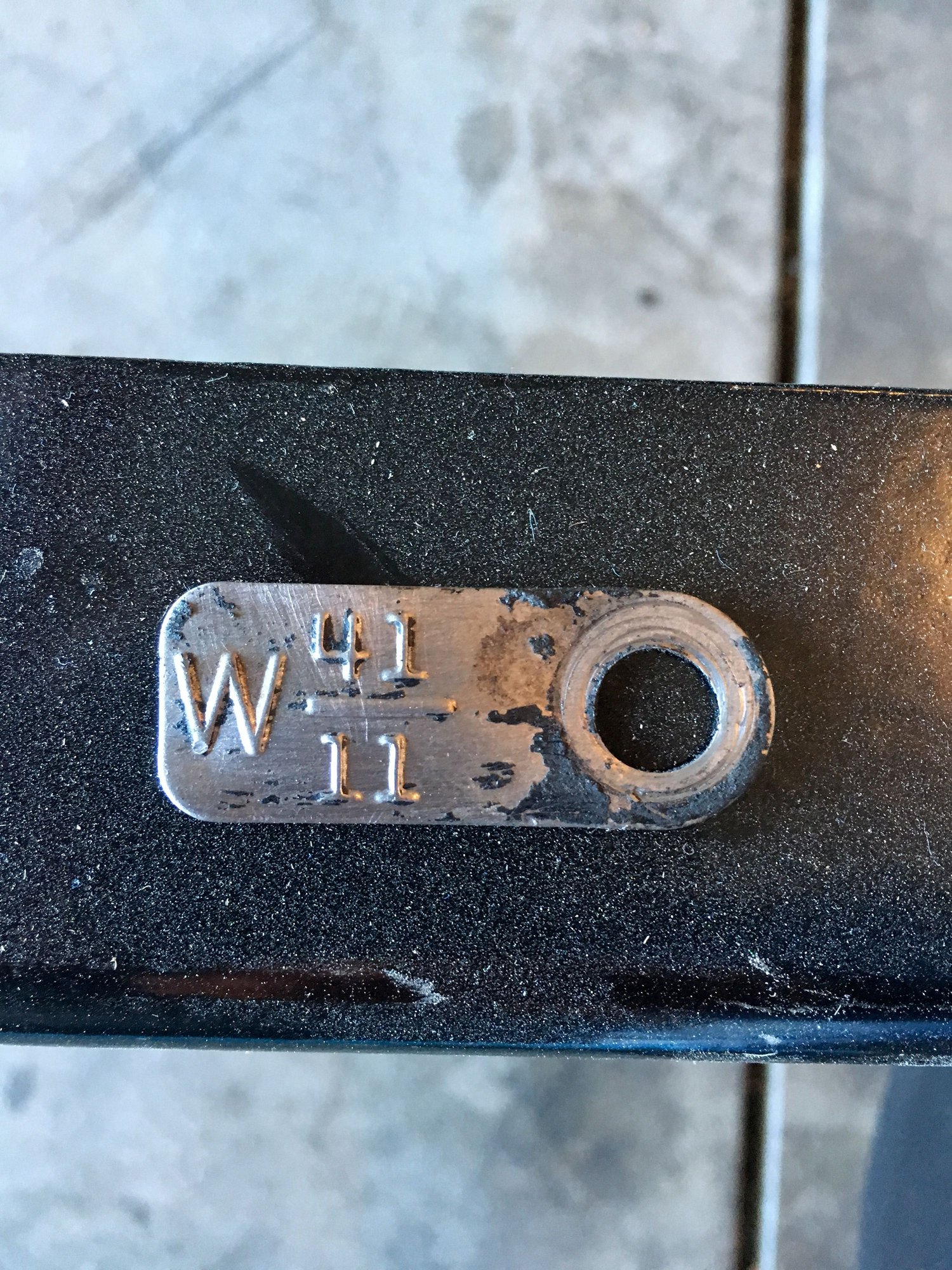

can you tell me what bolt the tag usually was affixed to? I have a Dana 41. I had a tag on mine and I didn't take pics of which one it was fastened to. Just curious. Thanks

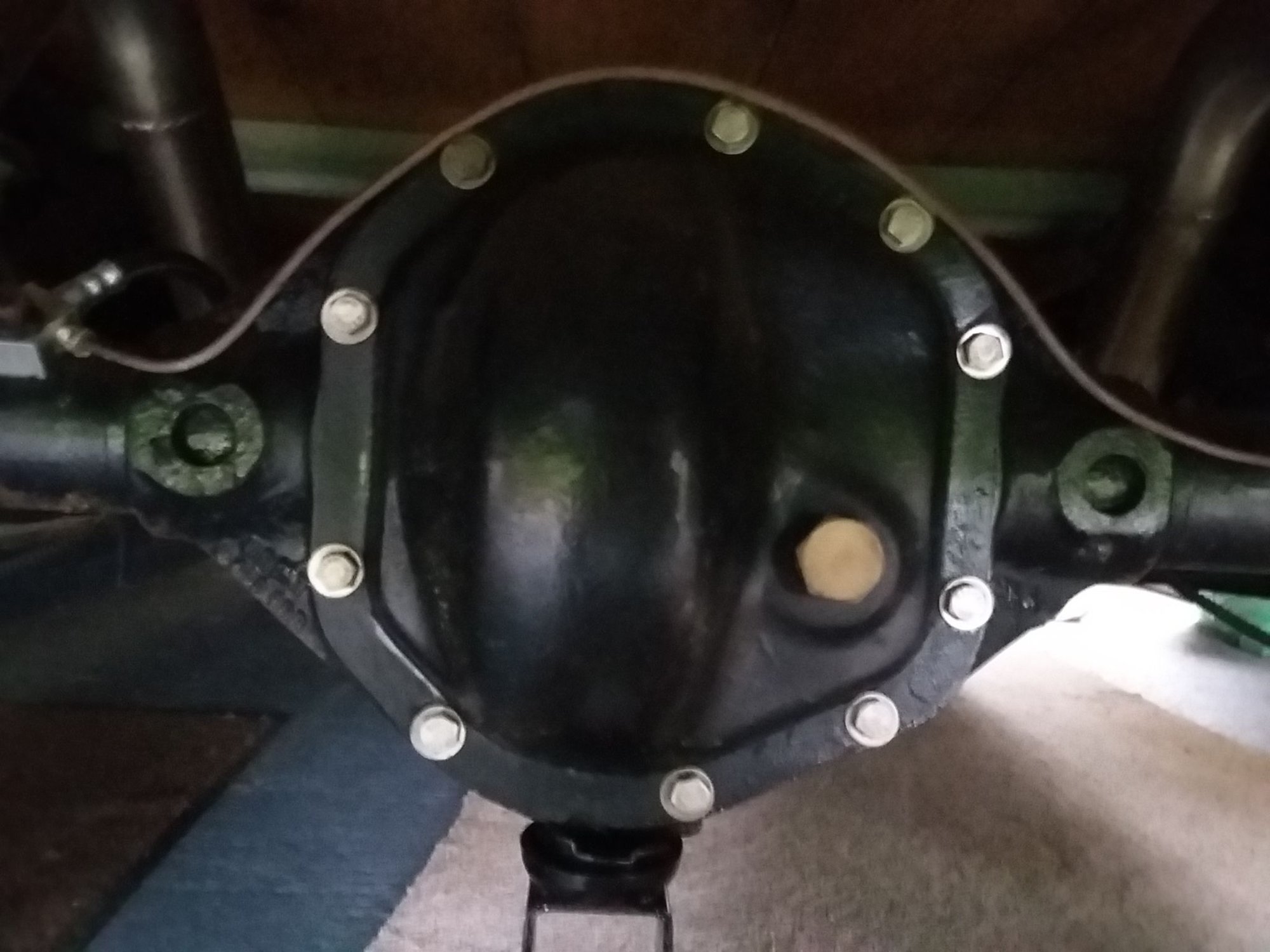

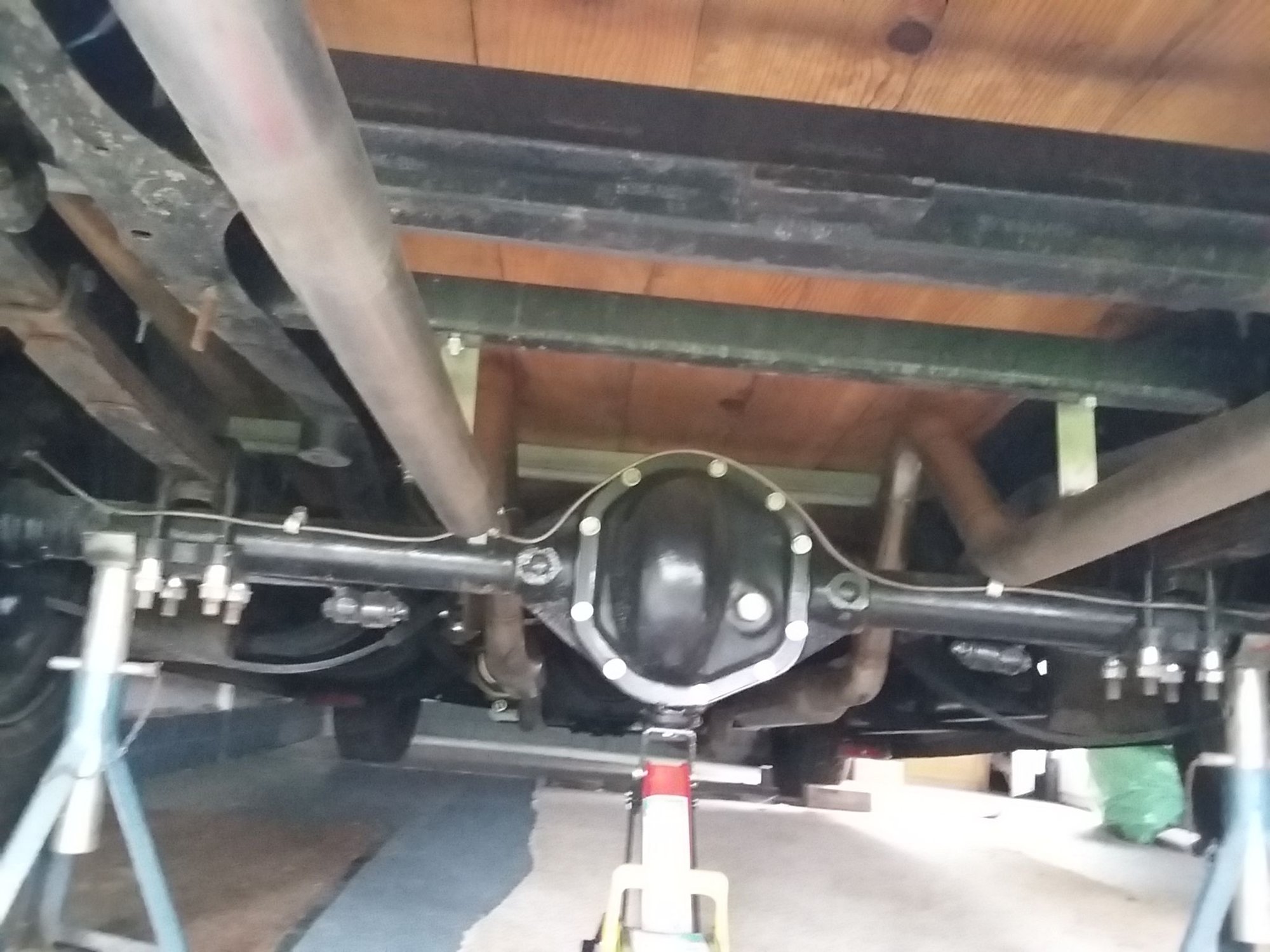

I have attached two shots of the axle. A close up of the diff unit and a full width pic. There is no tag as far as I can find. The axle measures approx 55 inches from backplate to backplate.

That’s definitely a Dana 44. Ring and pinion gear sets and all other rebuild parts are widely available and gear can be found in just about any ratio you can imagine. If it fits a Dana 44, it will fit your axle. BUT! The problem that you’ll run into is the carrier. The Dana 44 had a carrier split meaning that all gears sets 3.92:1 and numerically higher used one carrier assembly and gear sets 3.73:1 and numerically lower used a different carrier assembly. Your axle most likely has a 3.92:1 ratio as that was the most common standard ratio. You would have to pull the cover off and count the ring and pinion teeth to verify this for certain, but if your engine is wound out below 60 MPH as you state, it’s a safe bet that you’ve got a 3.92 or higher gear in your axle. You’ll probably want to swap it for about a 3.55:1. That’s a good compromise between highway speed and reasonable power for acceleration with an original engine. This will require replacing the carrier with a 3.73 and lower carrier assembly. The hangup with doing that is that these early model 44’s used oddball 19 spline axle shafts. To my knowledge, Dana never produced a carrier assembly for 3.73 and lower gears that would accept 19 spline axles. The solution to this dilemma is provided by the aftermarket. Yukon Gear produces the carrier assembly that you will need. It can be found here:
https://www.ringpinion.com/b2c/Produ...px?ProdID=8331
That carrier will accept the spider gears and all the guts from your existing carrier that fit your original 19 spline shafts and also allow you to run your choice of gears in a 3.73:1 or lower ratio. Good luck and have fun!

Since your truck is a '50, it's more likely that you have a Dana 41. Towards the very end of '50, Ford started using the 44. It makes a difference when ordering parts. Also the typical 41 was a 3.73 ratio, with an option for 4.27. Look carefully at the casting in the area circled, it will have either a 41 or a 44 there. If you pull off the rear cover, the tooth counts are stamped around the edge of the ring gear.

I’ve got to stick to my guns on this one. He’s got a 44. The sides on a 44 cover are squared off and a 41 cover is almost round. The bolt spacing is visibly different as well. Here’s a 41:

Yes, it does seem like he's got the D44, no telling if it's even the original axle this long after manufacture.
