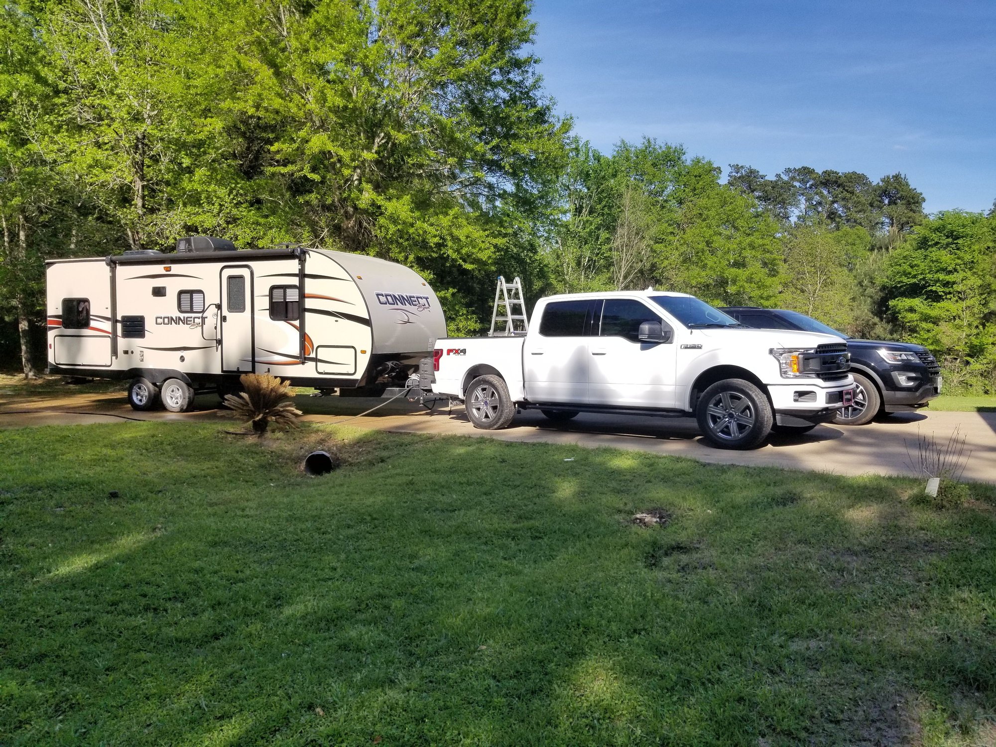

Max tow with 20s(12700 tow rating per tow guide) 1787 payload l, 13200lbs on hitch sticker , frame pn sticker says hpp. This trailer is 7500 tons of crap in the pass thru. It holds it up well without wdh hooked up. I will never tow 12000 with it but the pkg is nice to have.
