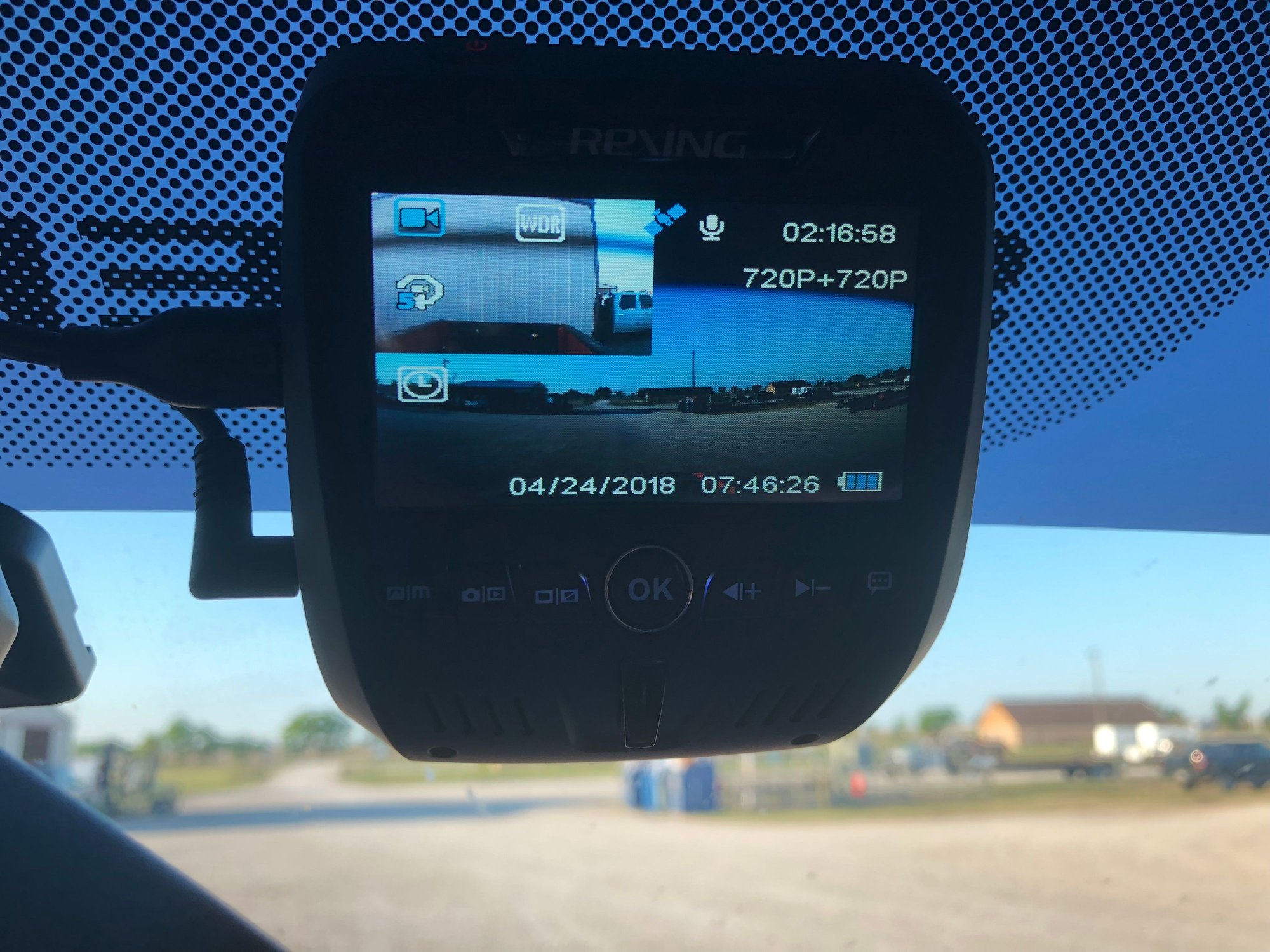

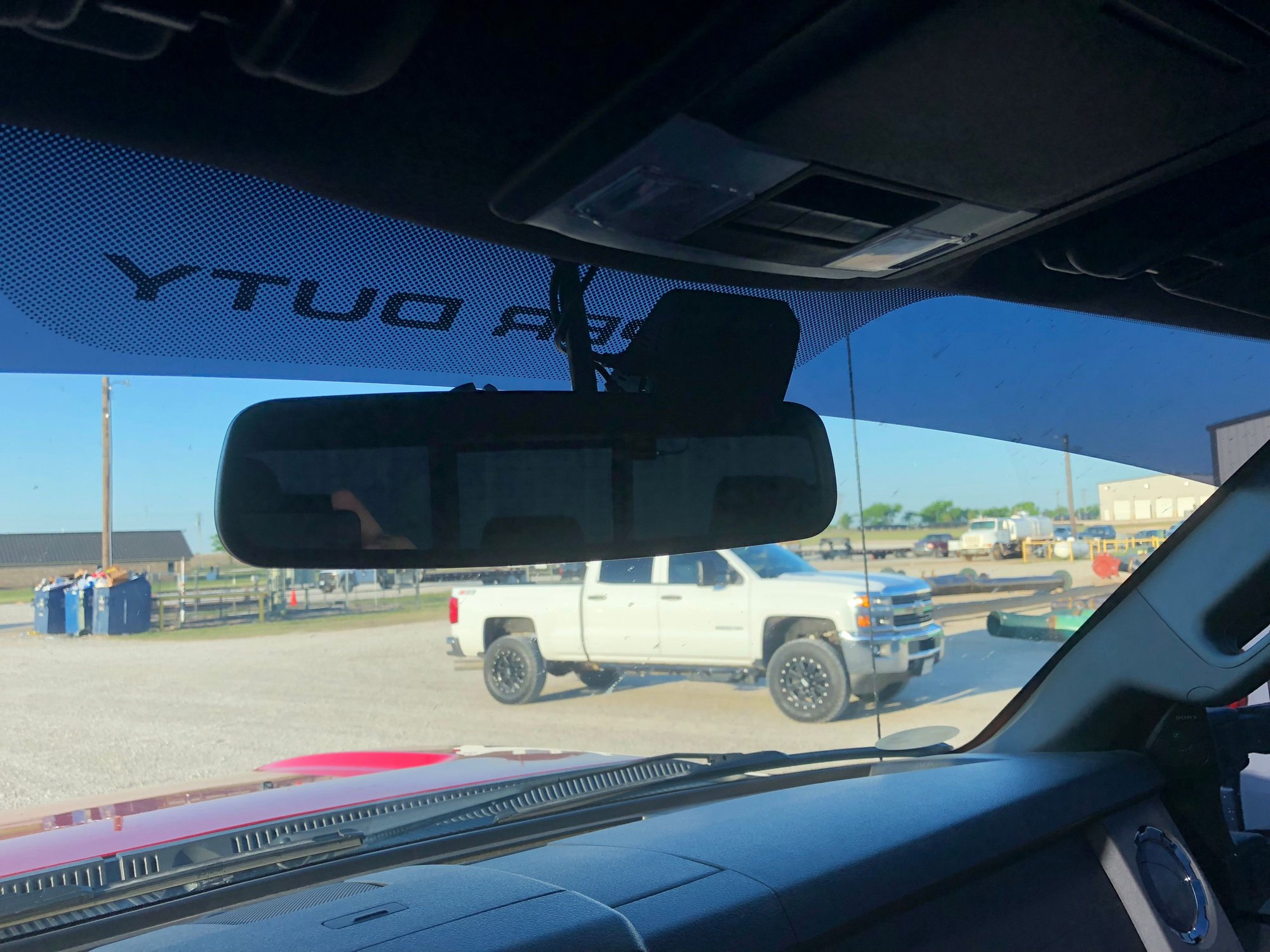

If you don't mind, post some pictures of your install and review of the camera when you finish. It's hard to find honest reviews on stuff like this.

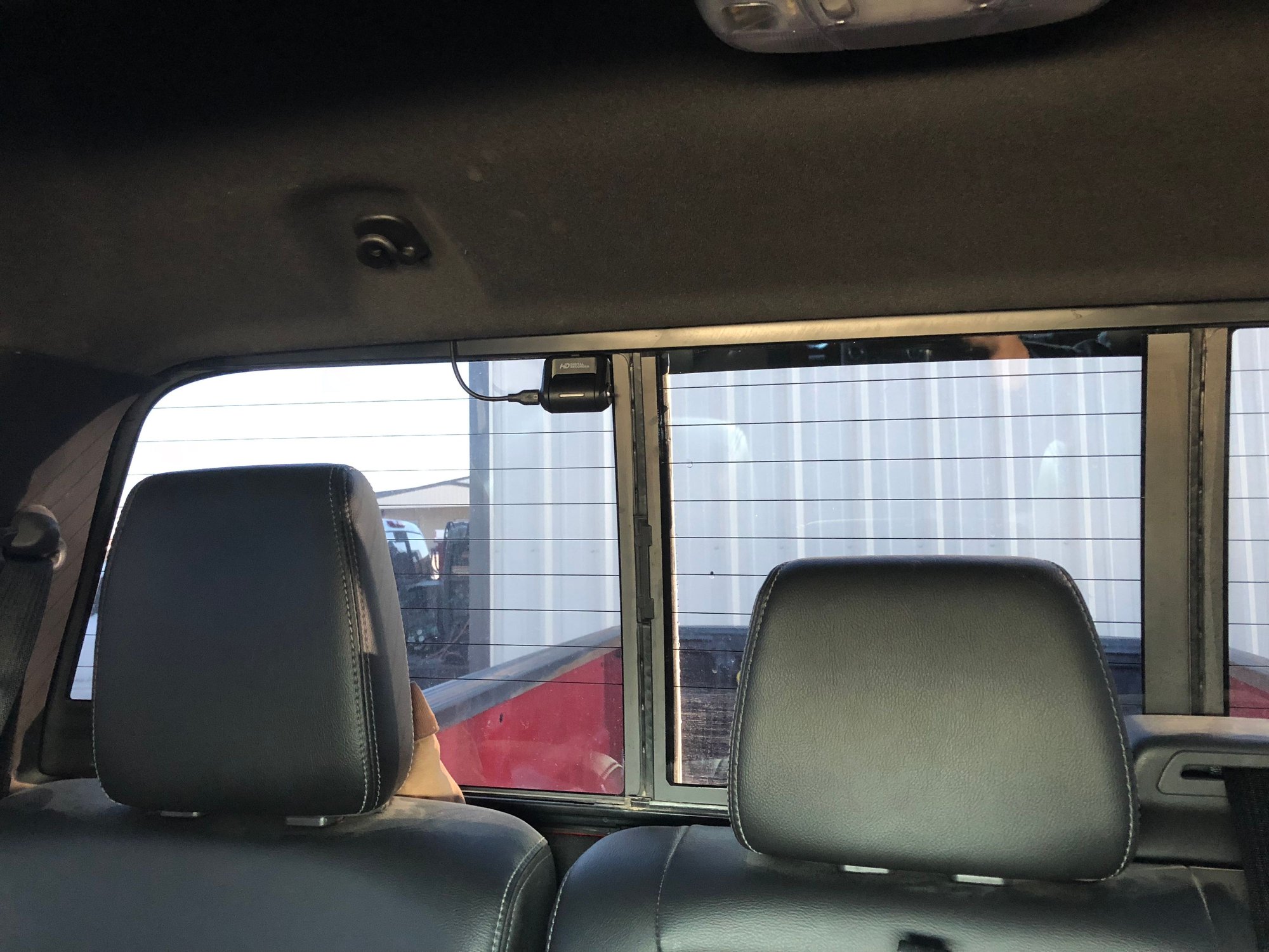

Old Apr 24, 2018 | 07:09 AM
Raptor34's Avatar
Raptor34
Joined: Feb 2018
Posts: 25
Originally Posted by ford390gashog
Do you have a sunroof? Easiest is to tap the wire above the overhead bin.
the sunroof is a 20amp fuse, I ended up going into fuse 44, which is the auxiliary switch fuse. I cycled the ignition and it worked as advertised. Give me a few weeks and I’ll hopefully learn all the gimmicks of the camera, but so far the only down side is the camera doesn’t show my speed, I have to view the footage on my computer to do that.
