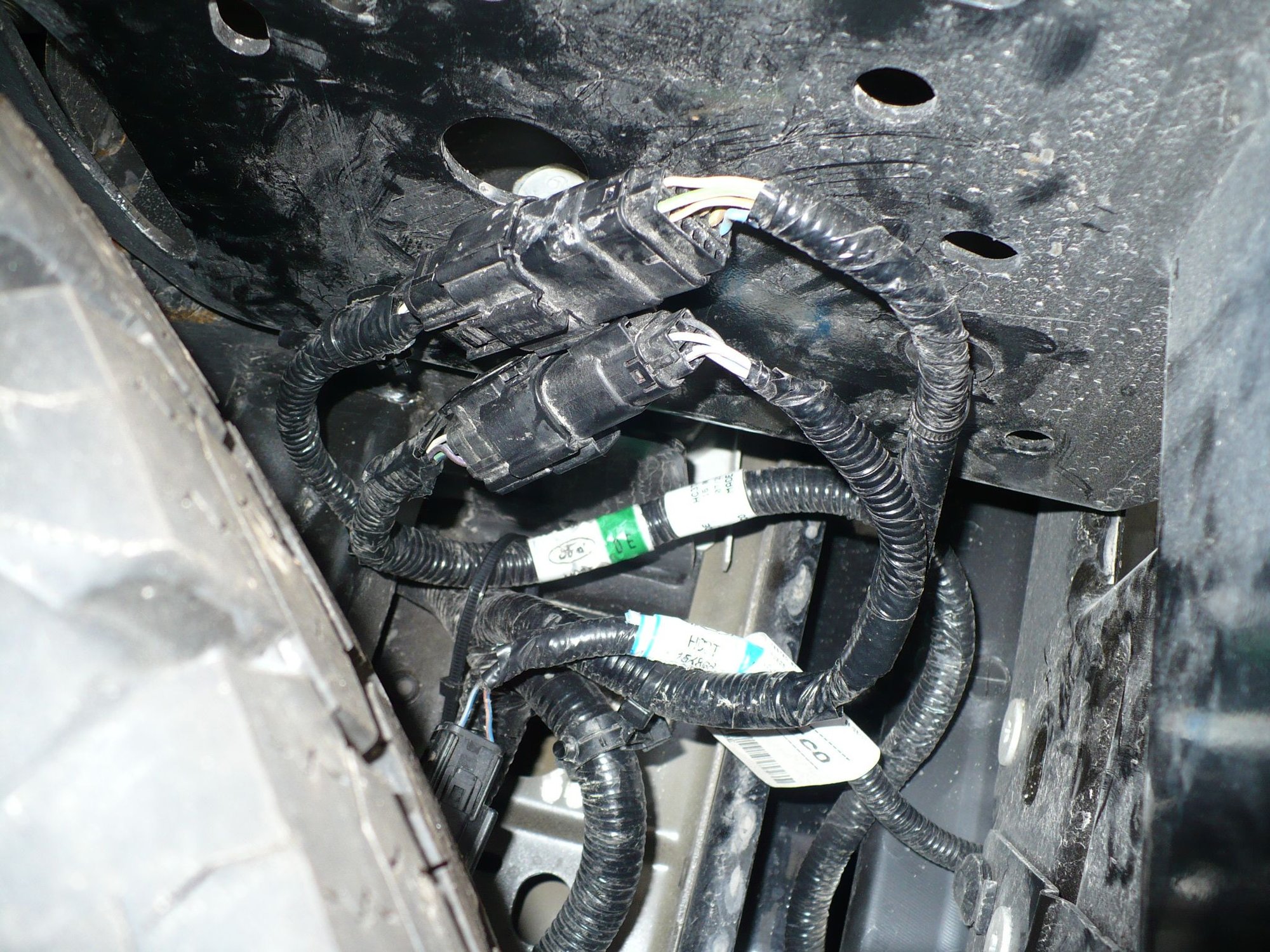

other side
From the back of the truck, right side looking up
Ok I went out today to dielectric grease the connectors in the rear of the truck. Problem was I couldn't find some of the ones that I saw earlier in the thread so I dropped the spare tire and low and behold there they were in a tangled up zip tied mess. My truck was rear ended back in November and one of the things that was delaying completion was a wire harness. I couldn't believe the body shop did something like this and I was pi$$ed. The harnesses in question still had the push in holders on them but they ignored that and just bundled it up in some kind of half assed mess. Got 'em all greased and put them back where I thought they went. Anyone who has greased your connectors could you look at the pics and tell me if they're in somewhat the right place? I'm assuming the harnesses attach to the insides of the hitch. Thanks

That second pic looks correct - mine are attached to the inside of the hitch like you show.
