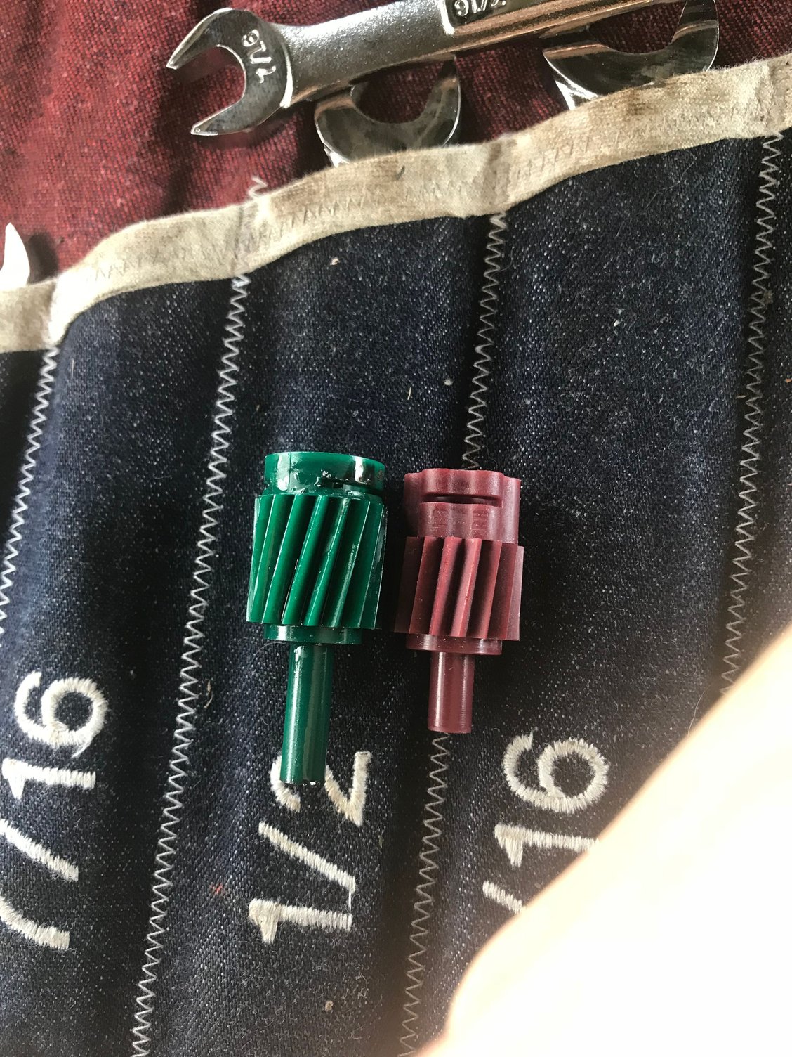

So I got the 16 tooth gear installed and it's much better as far as the speed goes but now my speedometer is really loud again. I think the longer shaft makes the difference. Here's a picture so you can see what I mean.
Does anyone know where I can get one with the longer shaft?

I've ordered the gear from here.
Ford Automatic Speedometer Driven gear AOD C-6
