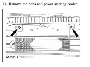

How Many Coolers?
Installed my all aluminum intercooler today. I was curious if there is a diagram of all the coolers up front on a 6.0? I had one mounted to the front support bar that didn’t show in the install videos I’ve seen. I had 5 coolers up front. I know there is the intercooler, radiator, transmission cooler, and a/c condensor. What is the 5th cooler?

Powersteering

I'm still wondering why I had a cooler attached where I haven't seen one on other trucks in install videos I've seen. Do I maybe have a larger cooler for one of those because of the snowplow package, so it's mounted differently?

How big of cooler are you talking about? The power steering is about 4” x 13” long towards the bottom behind the bumper

I had 2 coolers between the a/c condenser and the inter-cooler. One was mounted toward the bottom, not sure how big. The other was pretty large, maybe 24"w x 12"h or so and mounted with brackets to the radiators support bar.

Never mind. Looks like it was the power steering cooler.

Starting in some 2006 and all 2007 trucks the power steering cooler was moved from the bottom angled location to the top vertical location you have in the illustration. My early build 2006 still has it at the bottom. I don't remember the exact split dates.
